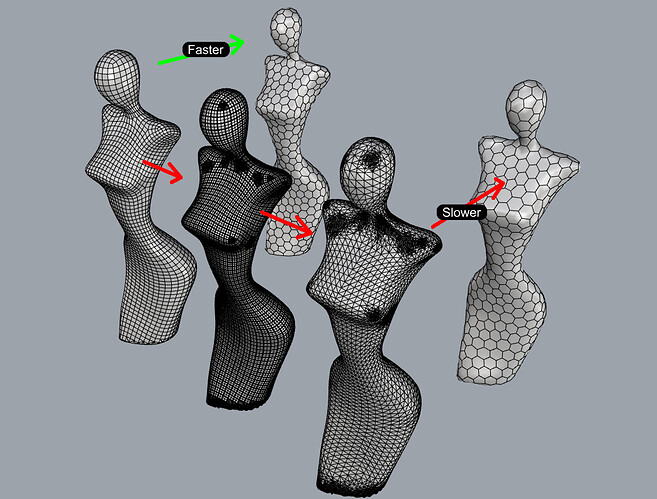

Simply projecting the vertices of the mesh dual polygons onto a circle gives roundish shapes but still a bit distorted
Whereas if you also redistribute the points so they are evenly spaced around the circle, it gives a much rounder boundary for the SubD (not perfect circles, but very close, and if you want even closer you can subdivide the sides to get more points first):
I also use something similar inside MultiPipe to get round sections.
Here, a SubD with 27 faces becomes a mesh with 529 faces, but TriRemesh does not have any options set except Iters, so what criteria does it use to turn a SubD into a mesh?
Hi @akilli
TriRemesh has the ‘Length’ input for the target edge length of the mesh.
If you do not provide any input here, it makes a guess for what seems a reasonable default target edge length to give a medium density mesh based on the size of the input object’s bounding box.
The density/number of faces/edge lengths of the input geometry do not affect this default.
My comment in my other reply to the OP above about converting to Brep was more related to the initial mesh created before remeshing. Although the density of this doesn’t affect the default target edge length, it can have a big effect on how long the remeshing takes and how many iterations are needed.
In their earlier file it looked like they had converted a quad mesh to SubD, then converted that SubD to a Brep with the face packing option turned off, which results in many individual NURBS faces, particularly around the irregular vertices, and input this Brep to TriRemesh.
When the input is a Brep, TriRemesh makes an initial mesh using the Rhino mesher before remeshing, preserving the boundaries of the Brep faces. This was resulting in a mesh with 28180 faces, compared to only 2766 for the original quad mesh, with no extra detail added. Starting with such a high density mesh means the remeshing has to do many more steps to reach a reasonable density, and also makes it slower because it uses this mesh as a target to keep projecting the new vertices onto during remeshing to keep the shape, and projecting onto a complex mesh takes longer.
So by switching to using their original quad mesh as input it made the remeshing step more than 10x faster to reach the same result.
