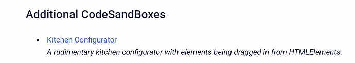

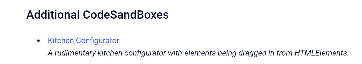

Hello. I’ve looked at the Kitchen Configurator interaction example in the CodeSandBoxes of their API documentation, however I still have questions about it in grasshopper about how the outputs and parameters themselves were generated.
Therefore I would like to ask where I can find the grasshopper files used in the mentioned example in order to analyze them in detail. Thanks.
