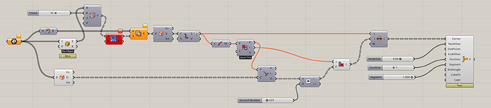

hello everyone! im fairly new to grasshopper and rhino, and i have a small problem with my bounding box trying to get this voronoi 3d right. you see, i dont know why its like on the edge of my brep and when i bake my voronoi 3d multipipe i get those curves i dont want, and i think its because of the bounding box.
i would love to get some help. im sure its a piece of cake
thank u :slight_smile:
The points are in a box and the voronoi diagram cells are based on a box.
You need to intersect the cells with the cylinder shape.
Something like this:
voronoi-cylinder.gh (14.7 KB)
If I’m not mistaken the request was to eliminate the segments that refer to the seam.
Good catch
voronoi-cylinder_cull-seam.gh (15.0 KB)

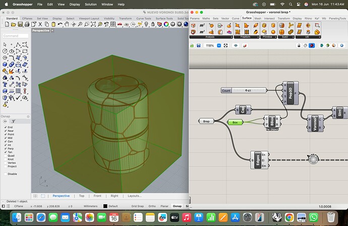

hellooo im back with my file.
still doesnt work
voronoi brep .gh (13.0 KB)
Please internalise the input brep.
i solved it!!! sorry thank you
i simply added a box and now its great
