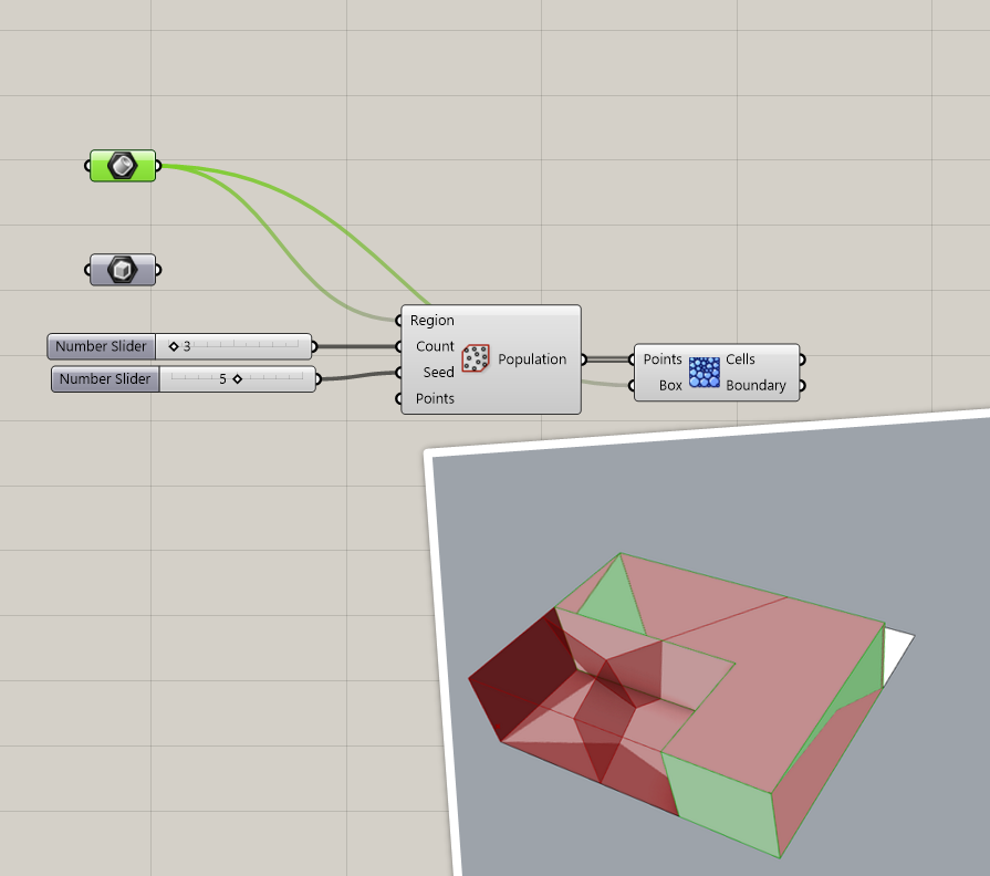

I am trying to input a brep for a region but it ends up taking a bounding box as a geometry.
(The L shaped volume is taken into consideration as a box when attached to Populate 3D and Voronoi 3D)
convert the brep to a region, using explodebrep, you can also test for points inside of the L shape and use those points only. You can also use the L shape as a ‘cutter’ to trim the veronai result
I want the voronoi to be only inside the L shape. Exploding the brep would again give me facves/vertices/edges. Not sure how to make that into a region again.
