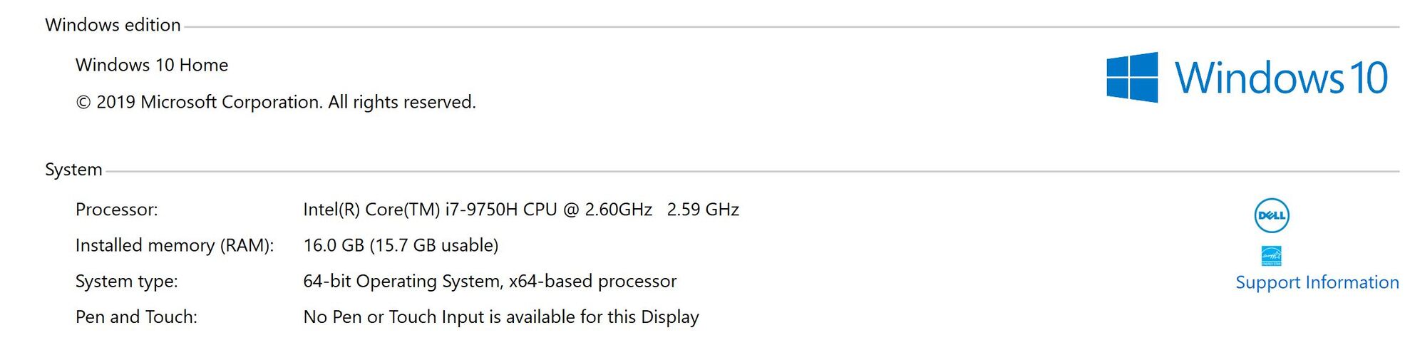

I also fear that maybe my computer doesn’t have the capacity to handle the displacement function very well and thats why i keep getting suboptimal results. Below is an image with the specs of the computer i am working on.
I did read online that displacement mapping is infamously hard on computer systems so this might very well be the case. Is there any way for me to increase my computer’s capability of handling displacement maps? Any external features I can buy to supplement my current set up?
