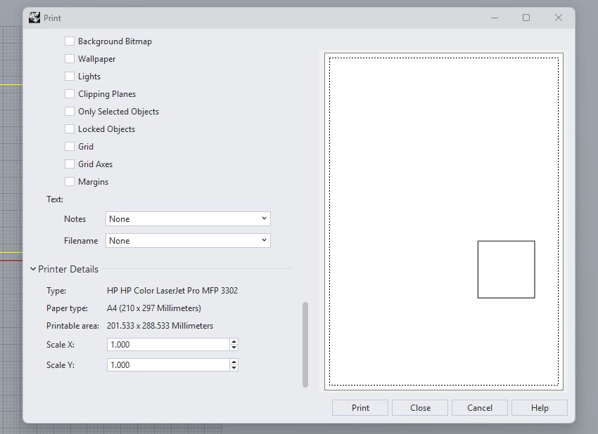

The print setting scale (plotter or large inktjet) does not hold it goes back to 1:000 after each print , small issue , had the same in R8

hello Wim that works ok keeps the setting
but in printer details scale x and scale Y it does not hold the setting for as i need X1.0022 that may not sounds much but on a drawing from 2mtr it is about 5mm so it is noticable in some points
btw i noticed that when staying in the same drawing it holds the setting
well must be something , it does hold the scale setting now when starting up again.. strange as it did not . ok problem solved then
well got some solution for the scale setting not holding
basicly it does not hold, you can dial in for example 1.0022 but it returns direct to 1 ..
i found out that this happends only in some drawings , not all , very weird that it does not hold , solution, copy all in the drawing open a new rhino file and paste , then it holds the scale setting.
why is tyhis happening on some drawings only ?

a empty drawing also works (or better does not) enclosed here it is about the scale setting for a plotter, the X dialed in 1,002 will go to 1.00 after going to the Y this does not happend when you copy all and past into a new drawing
