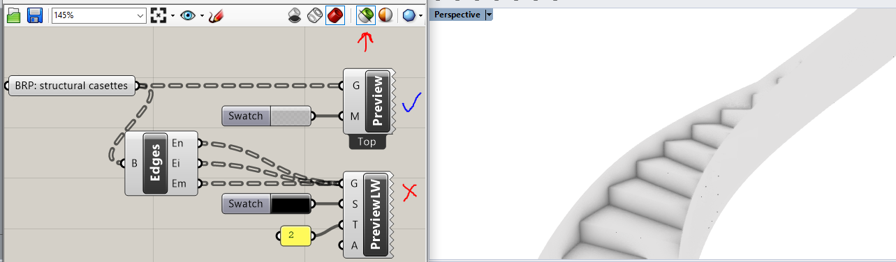

I’m encountering an issue where the Custom Preview Lineweights component doesn’t display anything in Rendered/Arctic/etc views when the “only draw preview geometry for selected objects” option is toggled on. I would expect this component to function the same as the native Custom Preview component, which renders regardless of the “only preview selected options” toggle. Is this a bug or intended behavior? I’m working in a very large GH definition, so having the “only preview selected objects” toggled off is not an option.
A fix for this issue or an alternate method for rendering curves or brep edges from GH would be very helpful, thanks!
