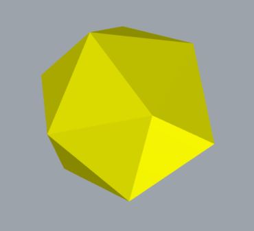

I have been working with polyhedra for years. Now, suddenly, my models have naked edges.
icosa with naked edges
instead of this:
icosa repaired
Why is this happening?
A guess is surface normals may be flipped.

By the way, this one does not have naked edges, but if I Check Mesh, this is what I get:
This is a bad mesh.
Here is what is wrong with this mesh:
Important things to consider with this mesh:
Mesh has 12 faces with directions different from the mesh as a whole.
12 bad.3dm (34.8 KB)
UnifyMeshNormals will reset the mesh normals so they all face the same way. If the mesh is closed all normals will face outward.
Right. This looks more like something has changed relative to how mesh facet normals are displayed.
These are not naked edges.
These are individual mesh facets with their normals flipped wrong side to.
One work around could be changing the Shaded working display mode so both sides of the mesh facets appear the same.
My guess is your display mode has backfaces set to be culled from the display. The default setting is for backfaces to display the same as front.
Are you set to cull?
If so change the setting or click the big Restore Defaults button at the bottom.

The first setting to Cull backfaces did not solve the problem.
Clicking the Restore Defaults DID solve the problem. The funny thing is that I had tried Restore Defaults several times with no success.

But when I started a new model, a simple dodecahedron, it came with the same problem. Neither set to Cull backfaces nor Restore Defaults solved the problem.
Mesh repair worked.

I can confirm that the older V6 version of RhinoPolyhedra results in some flipped normals in the dodecahedron shape.
I needed to run UnifyMeshNormals to sort it.
This has been fixed for the V7 version of the plug-in.
