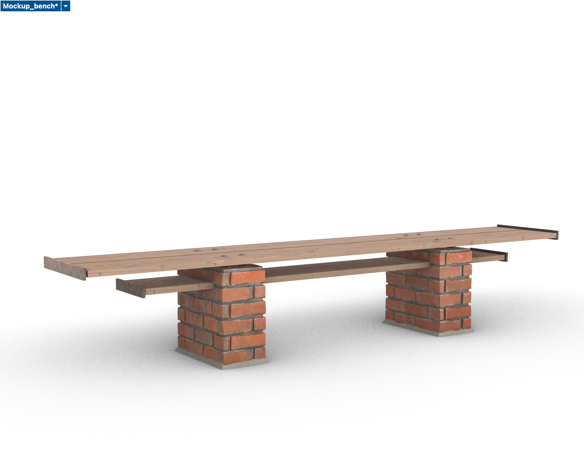

Every time I try to render my model in raytraced view the brick turns black, I have tried this in multiple different models and the same problem happens every time. I work on Mac.
How can I fix this?
This is how it is supposed to look like in rendered view:

@Aleksander_Ainsley you have subsurface scattering turned fully on with black as the scattering color.
Turn off the subsurface scattering (amount to 0.0) and it’ll look good.
Note that you also have a displacement texture, but since your geometry is already displaced it is better to turn off - and much faster to get started Raytracing.
