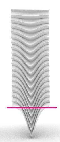

Hi all, I am trying to reproduce this exact shape from the photo (attached).
I already modeled something very close, but I still cannot match the same behavior / curvature the real object has. Can anyone please guide me or point me in the right direction?
I would make it using simple loft from a bunch of vertical planar curves
I’ll try this solution.
ribbon.gh (23.0 KB)
thank you so much for your help, I have two questions:
how can we cut the bottom part without damaging the overall geometry? (i showed in the attached picture)
how can we vary the spacing between layers irregularly, not at a uniform distance?
One way could be this.
ribbon a.gh (20.9 KB)
