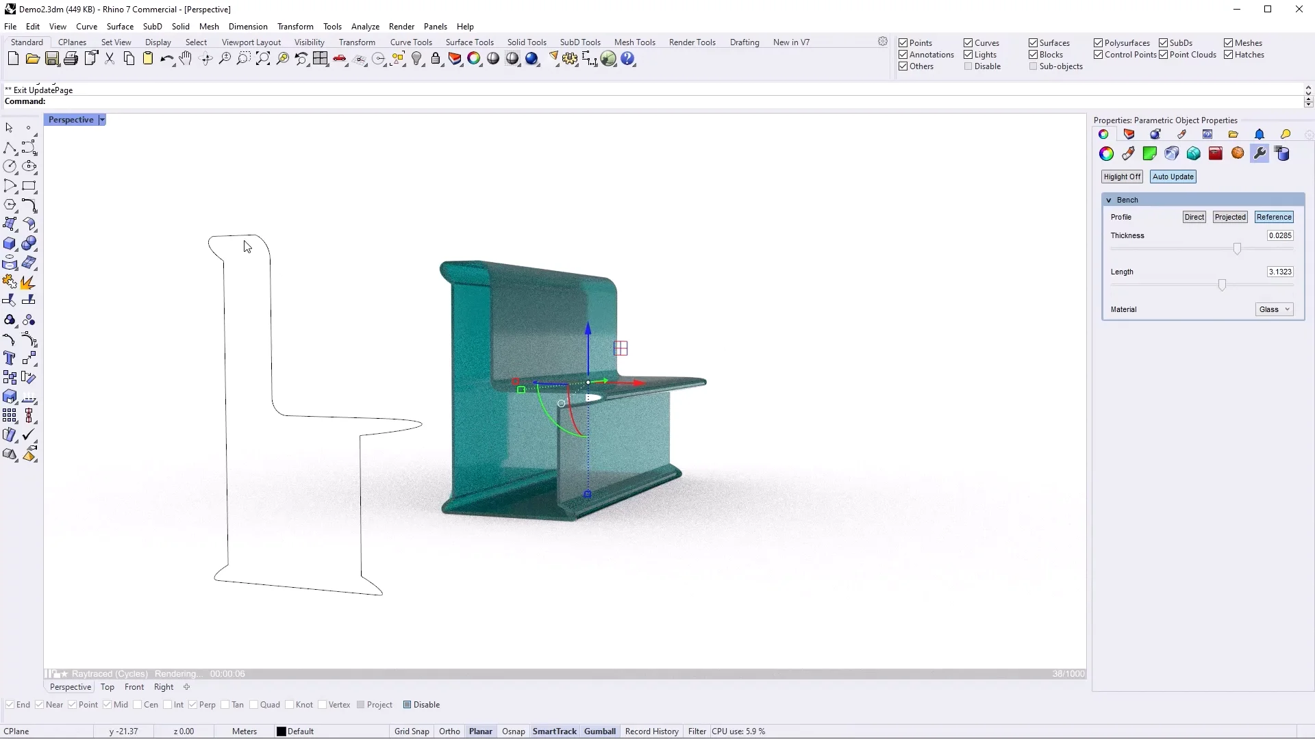

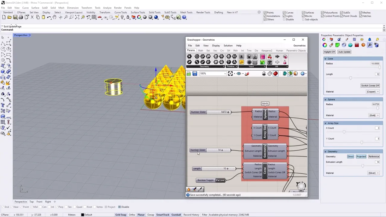

  • Add input parameters & groups, and components for output geometry to a grasshopper definition.

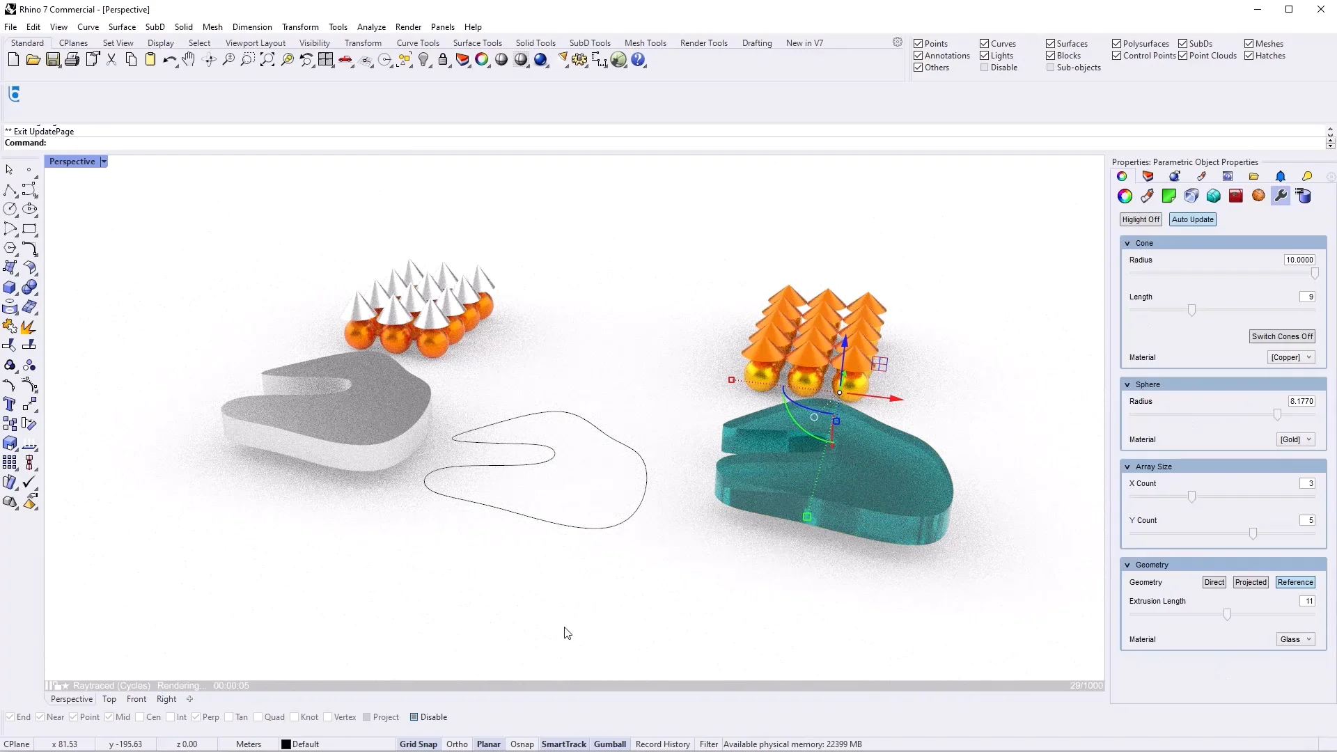

  • Selection of Parametric Objects in the Rhino scene & editing of parameters (Numbers, Bool, Geometry, Materials, etc.) in the object’s property panel.
  • Referencing of other Geometry in the Rhino scene for (optional) auto-updates of Parametric Objects.
  • Loading of Grasshopper definition files as templates in the Rhino document & insertion of Parametric Objects from templates into the actual Rhino Scene.
  • Rhino users do not need to open grasshopper or the definitions files in Grasshopper, they can just be loaded & used from Rhino.
    So you could have Grasshopper experts writing the Grasshopper definition files & Rhino experts who are just loading & using these files in Rhino.
  • For a summary of the current features, please watch the videos below - more features are in development :slight_smile:

GH_Player is more like a Rhino command. If you want to change the parameters afterwards, you have to run it again with different parameter values and create a new object as result.
(I think referenced geometry can also be dynamic with GH_Player, but not all other non-geometric parameters.)
With my plugin, the inserted objects stay fully parametric, you can just click on it in the scene any time & change the parameters directly in the GUI (as in my videos above).
