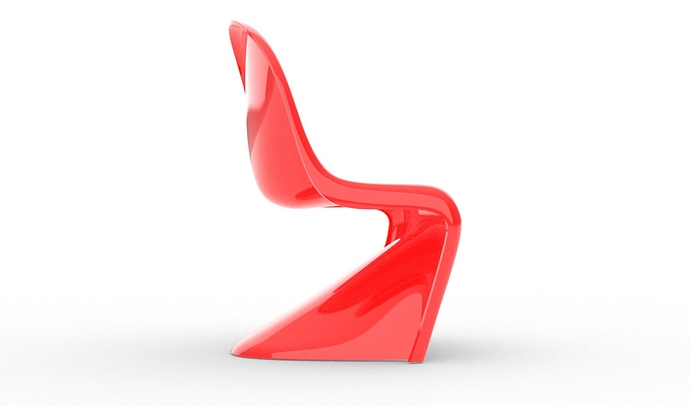

Panton Chair - SubD Model Attempt
I wanted to try SubD and see what I could learn from it. Never touched Max nor done more than a Coke bottle in Maya. FWIW, I really rate Blender since the 2.8 update and this has made me want to learn some polymodelling, so I am still wondering if it’s the better to place to cut my teeth.
I thought doing the Panton Chair would be something that’s both doable, but also challenging enough. I learnt quite a bit from it, coming from someone who doesn’t really know what to look for. Process was mainly by guesswork, but:

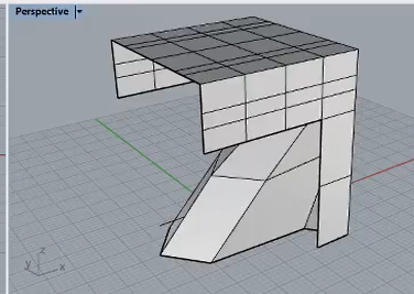

  1. Made a Cylinder. Saw the pole. Realised it was going nowhere.
  2. Made a Cube, realised it was a better start.

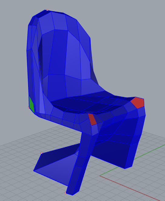

  3. I then ended up with this topolgy by some accident, where the red ngon on the corner gave me kind of the right flow. I persevered with the green corner for the back radius for a while, although knew I was kidding myself.
  1. At that point, my idea was to basically kick out the topology in the bends and kind of join up straight, and to then sculpt by hand. But I thought I would see how QuadRemesh fared.
  1. QuadRemesh did basically all the hard work and thinking for me which was handy. No idea if the flow etc. is considered ‘good’ but I had the control I wanted.
  1. Removed superfluous edges, figured out how to rebuild a dodgy corner
  2. Noodled for a while (too long probably) based on images. I didn’t use any PictureFrames etc.

Model here for anyone who wants to see:
Panton Chair _ JH.3dm (501.8 KB)

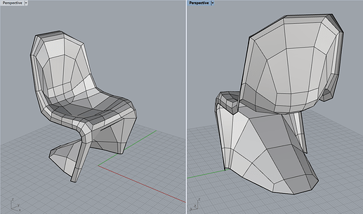

Remember make less do more in subd and your result will be smoother and easier to manage-
simple, simple, simple… remove stuff till the model falls apart and then add the last thing back.
see below- (much more push pull/refine shape needed, but no extra geometry is)
Thanks Kyle! Yeah your way of doing it has hit it on the head. That sort of starting point makes it much easier. I tried to model ALOT of detail very quickly and it burned me a bit (eg below, during). What I’m excited by in SubD is using all the known tools to, as you did, build a cage. Not just primitives.
process
Below was my attempt at refined topology (right). But honestly I feel like there were plenty of ways. I’d love to know what sorts are good for what purpose. For me, I would probably be thinking about where I would be likely to make more edits., and build topology in a way that means that bit could be easily edited. I guess it’s not rocket science though. And, for example, to centreline or not to centreline.

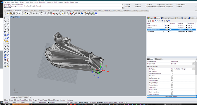

  8. I am seeing some strange display behaviour which looks like behind the scenes vertex order stuff rather than my aged GPU.
    1.Bug_VertexOrderProblem.3dm (344.5 KB)

Can you see 8. as a bug on your end? I’m seeing this kind of temporary thing a lot. I don’t have another GPU to compare to. sysinfo_jhut_wip_24.05.2020.txt (2.4 KB)
oof! that’s a rough one… your nvidia driver is about a year old and may be worth updating… does it do this for every model or just this one?
Yeah it does it very regularly - as I say the step is when having a face selected, and doing a toggle.
I’m looking into this now but I can’t find any available updates. It’s an Nvidia 660M. Nothing is screaming at me - Rhino WIP still gives me the notification tip but doesn’t have anything better or more update to suggest. The best I can do is get the 660 (not for notebooks). Anything that technical folks can recommend?
I really don’t see anything later than 11 / 04 / 2019 - 425.31
I see this one, https://www.nvidia.com/Download/Find.aspx?lang=en-us
but thats for a m600m notebook… I’d ping nvidia and ask them-
