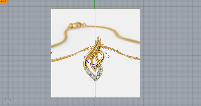

How would one go about creating a jewellery pendant like this?
My current method has been using a subD multipipe but I’m having issues near the sharp corners and getting things to blend smoothly.
Any help is much appreciated thanks.
In jewelry modeling, most parts that seem to be a “solid piece” are actually several polysurfaces on top of each other, and if needed some fillets on top. My advice would be to “block out” the parts, and make the transitions later.
Also, topology for SubD is a tricky bussines, but you can learn it if you but some time on it
You might want to collect some more reference images to get a sense of the whole form.
shrinkwrap the result and play with the smoothing value..
it has a remarkable ability to make this stuff go from trash to treasure…
all your self intersections will go away-
