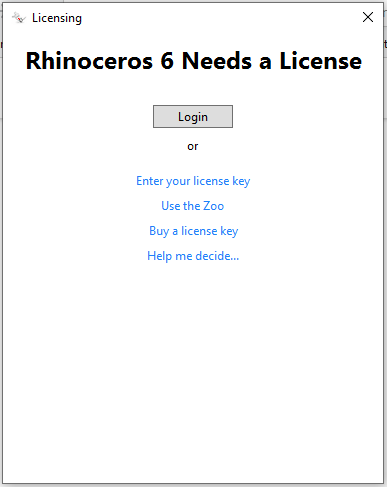

Hey John,
When I open Rhino 6 I see this screen:
I can’t seem to figure out how to open in trial mode from here…
Assuming your requested a 90-day eval from the Download page on the Rhino Web site, you would have entered your email address.
The system would generated a license key and emailed it to you.
Did you look in your inbox?
Ah yes. Sorry had done this months ago, forgot that evals were issued a license key. This works, thanks for your help.
