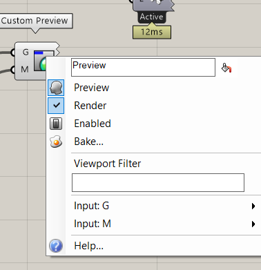

(Laurent Delrieu) #5
And rightclick on component to enable view in render mode.
