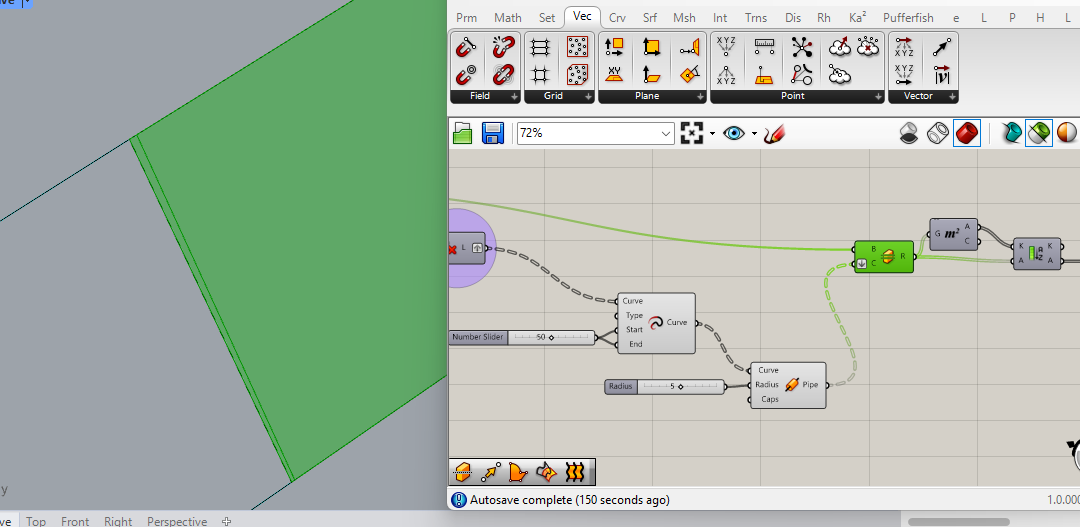

Thank you so much for your help. But why it is not working in my file?
Do your pipes have flat ends?
yes. But see, it seems top line is not in the main plane
I see, in this case the pipe would need to be extended.

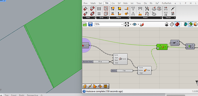

unfortunately not worked. because of these parts…
and still flat edge is not working.
extending will cause this issue
I know :grin:
You could extend all curves on both ends by at least 5 units, offset the vertical segments and then create e boundary surface. This should work unless your surfaces have very narrow parts.
Thank you for your help. It will not work unfortunately. I will try another way :folded_hands:
