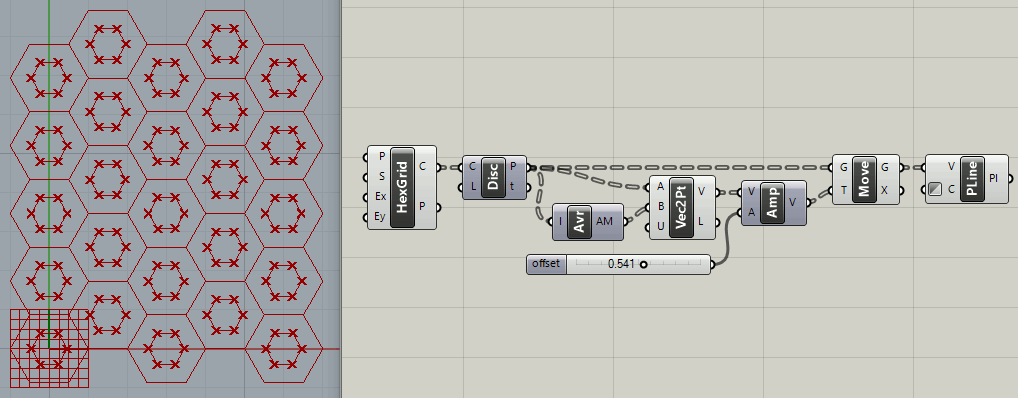

Get the Average of the points to find their center, then Vector 2Pt from the points to that center. Set their Amplitude to the offset distance and Move them.

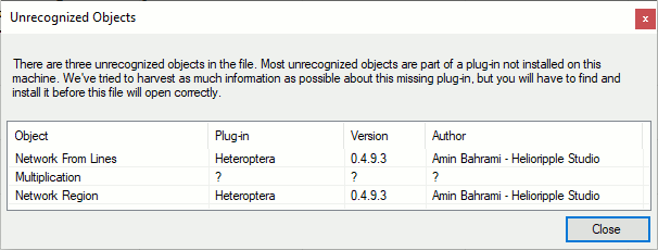

missing
move_to_center_2019Nov20a.gh (7.5 KB)
