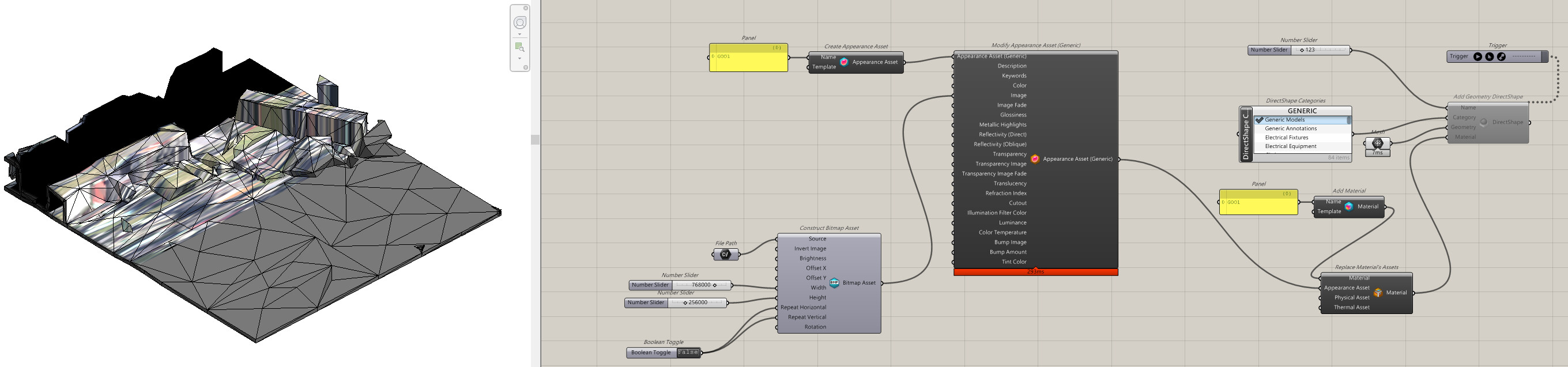

ctu6
(Ctu6)
5
I forgot to upload the bitmap, it has been updated in the first thread.
Here I try to brought it into Revit by using DirectShape and assign material.
But the mapping seems need a lot of work…
Japhy
(Japhy)
6
Hi Ctu6, Direct Shape and Family Forms aren’t suitable for controlling various UV directions.
