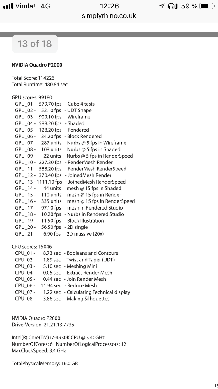

Yes I just read the document and there I found some Holomark benchmark tests on the Quadro P-series gpu’s. Quadro k-cards are obselete in comparison to modern Pascal Quadro cards and Gtx 10-series. Here are some benchmarks comparing the cards of interest:

That sounds lovely! However, I am concerned about FPS primarely and in the Holomark benchmark tests i posted above there seems to be a pretty huge difference between GTX and Quadro. For vido cards of the same cost. I am most interested in the fps for SHADED and RENDERED mode.
