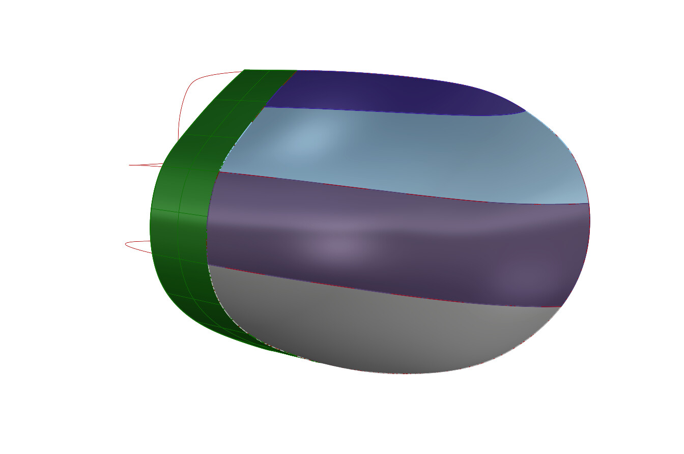

Hello, I need help from you Nurbs modeling professionals. How can I create this shape without getting such hard edges?
I’ve tried everything possible regarding division and creation but I always get a hard edge.

if you search a fast easy and rough solution - my guess is, there is no “vanilla” single rhino command.
The plug-in “xnurbs” will be a great help for this kind of surfaces.
parasolid patch / fill
Also the parasolid kernel (running in the background of solidworks, siemens Nx and others…) has a powerful patch / fill tool (cheapest access via plasticity.xyz) or here via onshape:

if you want a pure rhino nurbs solution, you’ll have to break down the surface. And quite sure there will be different approaches.
_curvatureGraph to check curve quality
_zebra to check surface quality
if you really rely on the (unusual) curve layout - my first approach - just a sketch / concept - using above patch to illustrate - would look like this:
rework the curves (check with _curvatureGraph)
1st set
build a _extrudeCrv as helper for symmetry (green) (but it might be easier to build the entire surfaces and do not work with mirroring )
_sweep2 or _edgeSrf for the central stripe (brown-violett)
for the remaining 3-sided openings:
_sweep2 _loft _edgeSrf (violett)
you might need _matchSrf and some CV-Massage for fine-tuning.
2nd
now trim back the violett surface and build a final _sweep2 to close the upper part.
also here you might need _matchSrf and some CV-Massage for fine-tuning.
do the same workflow for the grey section.
It might be easier to have a different overall edge (and maybe the corresponding / neighbouring surfaces ) - your closed, egg-like shape / edge / curve is a quite challenging choice.
but others might come up with simpler / other / better approaches…
kind regards - tom

Your tip regarding xnurbs was really worth its weight in gold. With Rhino you can create highly accurate Nurbs models, but you also need a lot of experience in modeling Nurbs geometries, as the curves also have to be perfectly prepared in advance so that the geometries/transitions are correct.
I downloaded the xnurbs demo and the result, especially considering that the curves are not yet perfect, is fantastic, especially for a model for visualizations. For the price the plugin costs, I will most likely buy it after the first tests.
Thank you
Looking at the zebra alone here, I think Xnurbs has given you a result which is going to give you a headache if you try to MatchSrf to that surface.
It’s worth using the PointsOn command here to see the underlying distribution on points. That will largely dictate what will happen if you try to match to even tangency on this shape.
I may be wrong, and hopefully it gives a workable surface, but I am just not sure that’s the case here; especially if it is a primary surface.
Yes, it’s not perfect yet, but for a model, for a visualization, it’s somewhat ok. But I’m still trying to see if I can do it more precisely/better. But I’m happy that with the xnurbs demo I can create geometries that are clean at the transition and don’t generate hard edges at the ends like vanilla Rhino.

you might get away with a single span surface, depending on the tolerance to the input points. For example:

Rhino 9 WIP has the SubDMatch command with a tangent option.
I extended the curves and used Sweep1 to create a surface for tangency.
The cone shape is not exactly like the curves provided but a little pushing and pulling and I think it would look alright.
