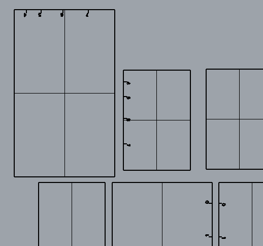

Hi all - Iā€™ll post the thing Iā€™m working from - it marks seams with little hash marks and adds a little bit of info to these so it is possible to match them up from the 3d to the 2d with a second script. That much seems to work OK, the next thing is to add numbering, which is a bit more involved but should be doable.
OK- I added a first shot at numbering.
To use these, download the py files and use
! _RunPythonScript
or as a macro for a button or alias:
! _-RunPythonScript "Full path to py file inside double-quotes"
Also, when you unroll the surfaces, make sure that KeepProperties=Yes so that the unrolled markers know about their 3d parents.
Pick a surface edge, then the two surfaces to mark - presumably on either side of the edge - then click click click to set markers, optionally with numbering. Command line lets you set the length, text size and current number. Only Arial right now, text wise.
The match script that finds the 3d marker from the 2d and vice-versa, in case that is of any use.
I donā€™t see how a cube would work at the moment, however, you could draw the straight lines once flattened, fairly quickly using the midpt and between snaps at each arc?

So, @alexkskim1, @fragged8, something like this, right?
3D:
Unrolled:
