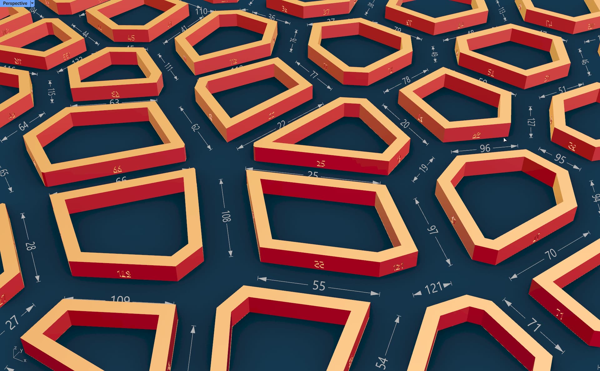

Number tags for 3d printing
I made this simple script of Voronoi pattern.
I would like to 3d print each cell seperatly and glue them together, but without knowing their exact order it would be very difficult.
How can I add a number tag as a part of the finel geometry? As in the attached photo for example.
Thank you.

Every edge in the polygon topology has an index.
This definition will etch those numbers into the relative sides of the BREP.
Edges with lengths too small to bear an etching will be excluded.

As to tag labels, you’ll need a plugin to get curves from digits or letters. Instead of mapping edge topology as @Quan_Li has done, it’s probably sufficient to just number the extrusions as above?
I’ll leave it at that for now.
I want to number only the extrusions as geometry of each cell. I’m trying to change @Quan_Li script to apply only for one edge of each cell.
I would be happy to know if you can give another method @Joseph_Oster
I have something added to my previous post that “engraves” numbers on the largest face of each extrusion. It depends on an old, funky unsupported copy of Text by curve from Peacock plugin, though that part could be replaced - certainly there is something better now?
Voronoi_2024Feb13d.gh (36.1 KB)

I started to write the white group that shows vectors pointing to the label on each extrusion, thinking it might help orienting the physical pieces.
In the process, I discovered and fixed a significant bug. Code was sorting faces to get the one with the largest area for placement of the labels. But it was ignoring the distinction between vertical (good) and horizontal (bad!) faces. Wasn’t a problem when the offset was small but when large, the top and bottom faces have more area then any of the sides, which is bad!! So added the purple group to cull vertical faces and only sort them for the labels.
