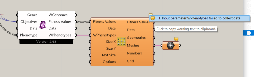

Receiving this error after running the simulation: “1. Input parameter WPhenotypes failed to collect data”. Unsure why I can’t see the phenotype. I inputted the phenotype geometry after I ran the simulation.
Hi Brittney,
to visualise the phenotypes you must first export them from tab3 in Wallacei UI. heres a short tutorial on how to do this:
