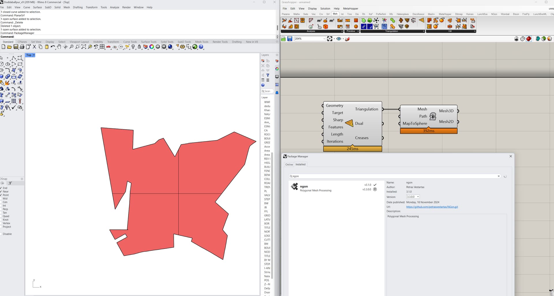

NGON plug-in not working with Rhino 8 Grasshopper on MacBook Pro M1 Max
test_mesh.3dm (2.5 MB)
heres the mesh i used as input
V3.3.0.0 is working on my MacBook Pro M1 Max with Rhino 8
Thank you!

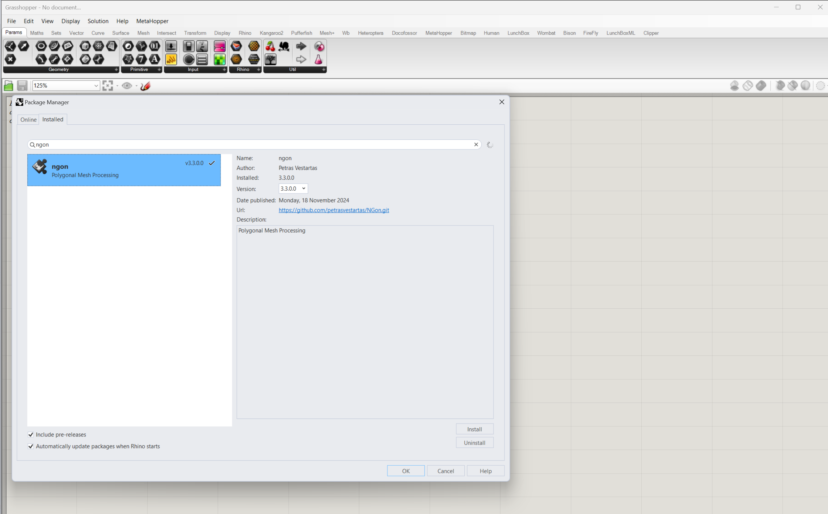

for some reason my 3.3.0 is not loading , perhaps some restrictions on the pc
3.1.0 works well even for large meshes in rhino8 in windows11, Thanks @Petras_Vestartas @nathanletwory , i eventually had to use another mesh mapping workflow, but this seems the best so far.
Can you see any error message on command line?
