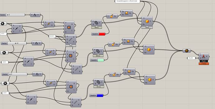

I’ve been playing around with the solid Hatch component for filling map polygons and I’m very impressed by how fast they generate. Some polygons overlap, and I’d like to control which one covers the other.
If I stack them on different Z planes and bake, it works as expected. Unfortunately, I can’t seem to control how they stack when printing a Grasshopper preview directly as vectors. Whatever I try, the draw order is constained to the sequence in wich the preview components are placed on the canvas.
PreviewVectorPrint-DrawOrder.gh (13.9 KB)
Any suggestions or possible future fix?
Hi Guido -
Thanks. I’ve put this on the list for a developer to take a look at:
RH-89010 Print: Fake2D: DrawOrder of Grasshopper Hatches
Hi @wim, Thanks.
For now, this workaround fixed the problem: packing the properties, merging into a single stream, and sorting before previewing.
It kind of forces me to build cleaner scripts, so that’s not too bad :slightly_smiling_face:
It is clear that the Grasshopper preview may not be using the same rules as Rhino for draw order. This is mainly because it is simply a preview and lacks a lot of the information a normal object would that has been added to Rhino. We have that YT to look at.
Here is a consistent way to “preview” and print the hatches. Adding them to the Rhino database with Content Cache then let content cache manage them. Of course, pushing them into Rhino may take a bit more time, as there is a lot more data being passed around. Might this work?
Thanks Scott, this is actually pretty fast.
I’m just wondering if there’s a way to automatically purge the geometry when the script is disabled or closed, similar to the behaviour in RiR components, where you need to Release Elements, which initially confused the hell out of me :slightly_smiling_face:
