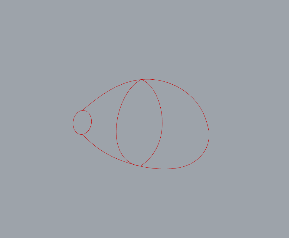

I have this setup right now. Its a very rough and basic shape to what I want to do, however I’m not sure how to approach making the surface from here.
You may split the top and bottom curve and make them rails>sweep2 starting the cross section with a point. If the singularity is not right you may try a patch there.
Thanks for the help! I ended up splitting the curve in the middle and adding some more profile curves to make the shape more defined and then used curve network
