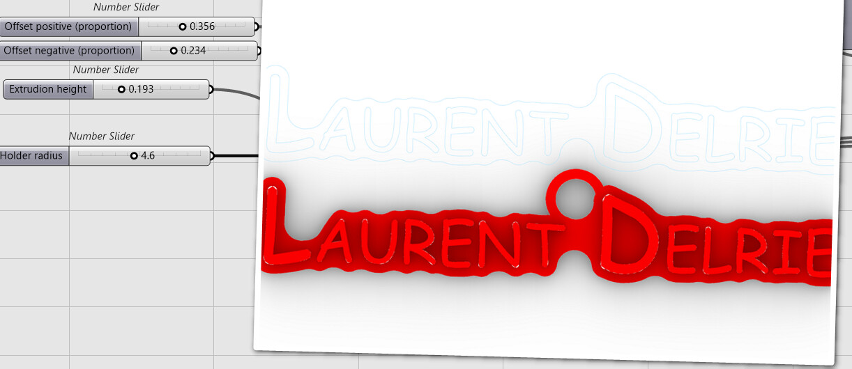

Hello
you can use this component to make text
then
extrude the text.
Offset the text using Clipper tool
I use 2 offsets one positive and one negative in order to bridge letters/words
Clipper is always doing a positive and a negative, so choose the output.
then extrude, join meshes as join Brep doesn’t work for some reason.
Then calculate Center Of Gravity in order to place holder
And if you want better boolean reliability Use Dendro
