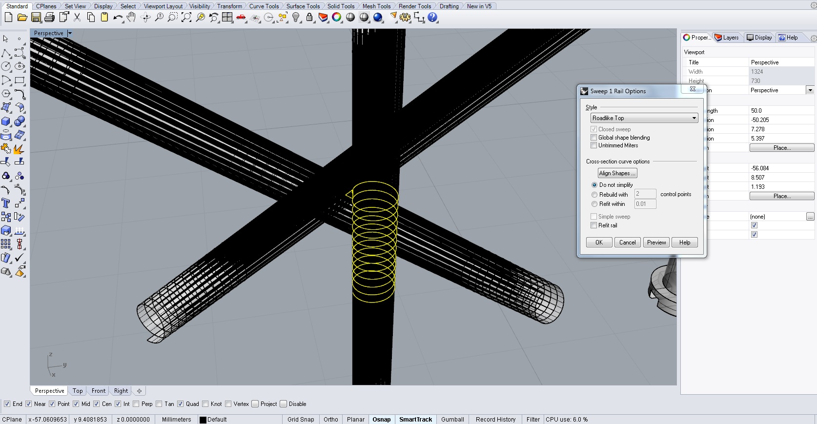

I’m having a pretty big problem while trying to model screw threads, i created a helix curve, i created the thread shape itself, and i’m trying to use Sweep 1 Rail to make the thread profile follow the helix and i’m just getting a big mess of surfaces, i can’t seem to get anywhere at all with the Sweep tool.
Nevermind, i figured it out. I was selecting the profile first and then the helix, when i should have had the helix selected before the profile, it’s all working fine now.

Thanks guys, but the screws i’m making have thread diameters of 0.38mm and 360 tpi, it’s not something you can buy, at least not that i’m aware of, so available models generally won’t work, even when scaled down. I figured out how to model it properly though, so it’s not a problem.
