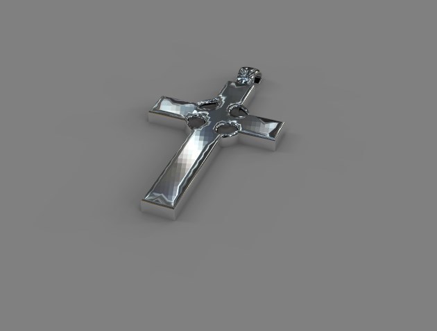

The cross is sterling silver and I would like to get a render that I can use to show a customer and use the environment for all my pieces.
cross sor Flamingop Environment.3dm (679.2 KB)
Any suggestions? I really need to get a good render I can use.
Do you have any example renders showing what you want to change or don’t like? Here’s a quick example with your model as well. I turned on the ground plane and rotated the model slightly to appear as though it was resting on the ground. I then adjusted the brightness in the Render window>Adjust image section. I left the Beach Probe HDR file in the skylight that you had previously chosen.
Brian,
Your rendering certainly looks much better than mine. The piece does not look like polished silver. How can I make it more shinny like polished silver?
The illusion of shine and polish is reflection. Try a more interesting HDR file or place an object in the the scene (perhaps a PictureFrame or add an environment image), that gives the polished material something to reflect.
If you walk up to a big chromed Buick bumper, what do you see?
You see your knees and the environment around you.
That’s what makes it look polished.
That same bumper in a gray environment will be gray.
Here’s your model again with a ground plane and a different, more interesting, rnl_probe.hdr sky light. It shows the cells of the image so clearly it needs more tweaking, but it looks shiny because it has something to reflect.

That’s due to the low resolution of that HDR. You can reduce the Sharpness in the material to blur the reflection to compensate or use a higher res HDR something at least 1024 x 2048 should solve the problem. nXt’s default HDR files are all really low res unfortunately.

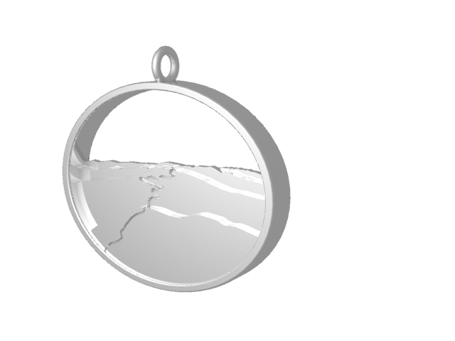

wow @BrianJ Is that with the rhino render or a plugin? I have never been able to get my metal to look so good. appgap%20render
That was done in Flamingo nXt. The key to realistic metal with any renderer is often the use of an HDR environment. Try the Rhino 6 for Windows evaluation for an easy set up

Thanks @BrianJ, I got Flaming and have been playing around with it- I also found some video tutorials which were helpful. One thing I can’t figure out how to do is to reset to defaults? and even when I make the ground plane white it still appears grey. Thanks
Did you try the Rhino 6 for Windows evaluation
https://www.rhino3d.com/download/rhino-for-windows/6/evaluation
My instructions were specific to that version of Rhino and did not require Flamingo so that may be the confusion.
If you are using Flamingo as your renderer, the ground plane may look grey depending on the lighting even if it was assigned a white material. You will need to use the brightness adjustment in the render window to override the ‘tone mapping’ that Flamingo automatically does that is causing this. The tone mapping prevents images from being too light or dark but can also have a tendency to lean toward grey as a result when using white materials.
