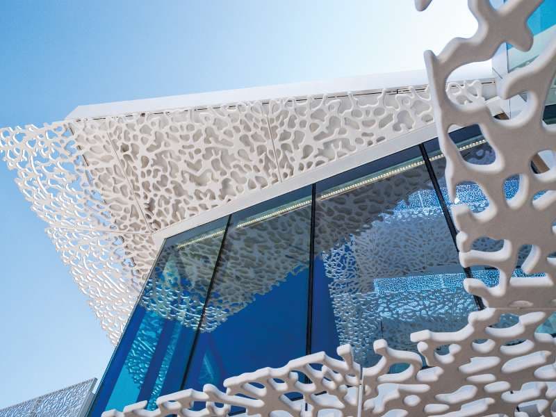

Need help creating a pattern
How would you guys create this structure usend in the Bvlgari Resort Dubai? I tried using voronoi but couldn´t reach this coral shaped pattern.

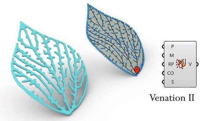

this type of pattern looks like Venation,
There are some tools in Parakeet plugin
https://www.food4rhino.com/en/app/parakeet
you can also see Nervous work
But from what I see here, this pattern is symmetric and it seems to be the same on all panels.
