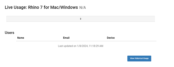

The Zoo license overview is showing wrong
numbers, one of V7 and one of V8 are always
shown as “in use”, but it seems to work now.
When it says “license in use”, does this include
the ~2 weeks “lease” or who or what is using
my licenses?
RhinoMultiZoo
thx
axt
You can click on the usage and view historical data/users
