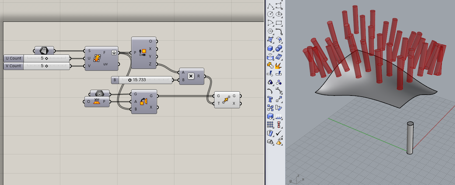

@kiwi, here’s a basic python that will do what I think you want, minus the nice interactive preview.
MoveOnSrfNormal.py (2.0 KB)
With Gh, will need some different set up to use your geometry.
move pipe normal.gh (11.0 KB)
