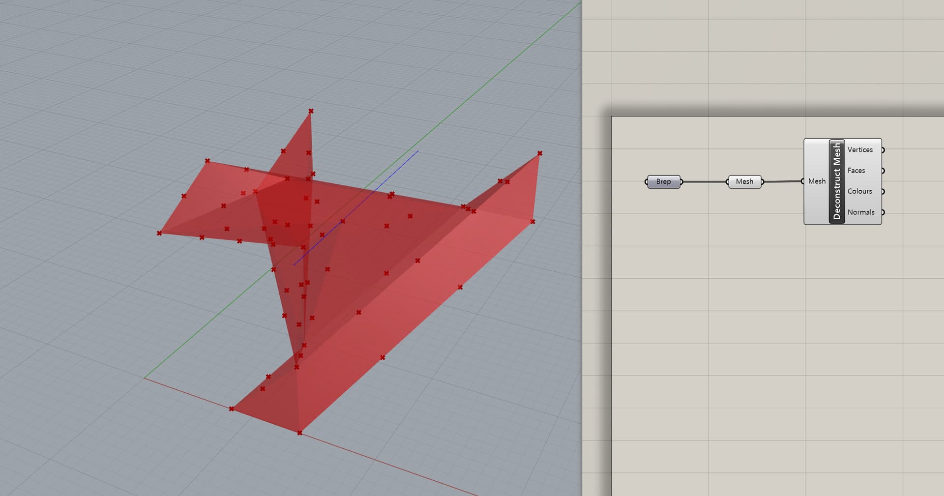

I’ve made it to mesh and got points.
Is there a way to select one point and move it?

Can my file work same way??
