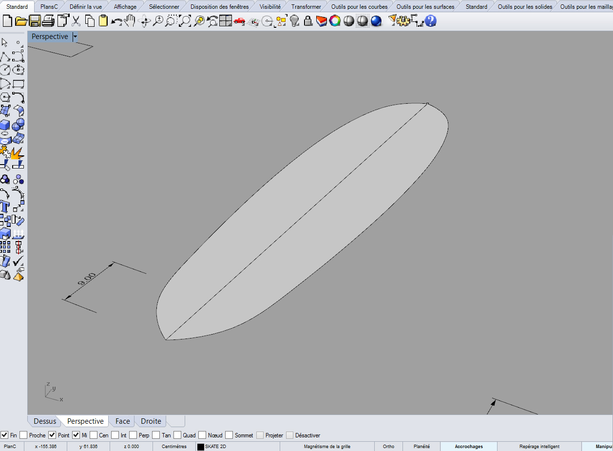

Hi!
Thanks so much for your advices!
As i’m a beginner at rhino, i tried to understand your posts, and now, here i am.
First, i did the offset surface command, with the option “solide”, and i have this, and thanks to this, the polysurface is closed, now! :-))
After, i did the boolean intersection of the two volumes:
And i have, now, the first sheet of the skatebaord, with 1.58mm of thickness:
Well, now, i’d like to know how to smooth this volume, especially the thickness, because we see i have angles, at the border, and i’d like to know how to smooth this:
Thanks so much!
:slight_smile:
Sandrine

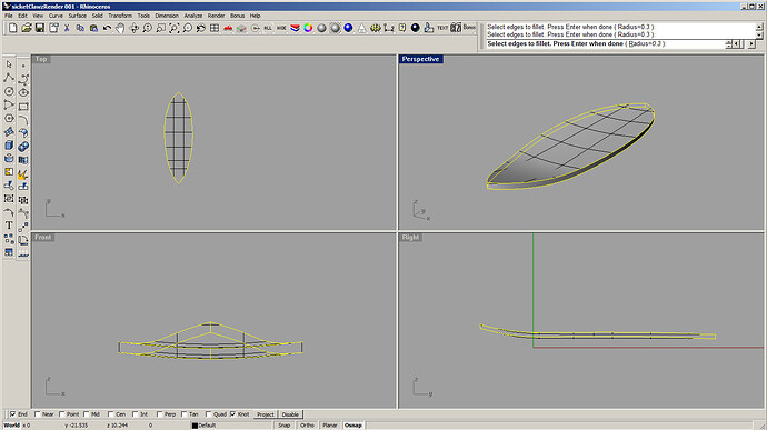

See if FilletEdge does what you want.
Another option is to create the front curves of the board along its short side to side axis, define a top board shape and perform a Boolean intersection to get your base board shape and curvature along the right / left axis. Fillet your solid appropriately, and then create a curve to define the curvature of the long axis of the board. Use the flow along curve command to finish your board with specific curvature along both axes. I can do a video if it would be more helpful.

Hi! Thanks! I don’t know where it is “Fillet Edge”, i have the french version, but i try to see in english where it is. Is it Solid, “Congé entre bords”, do we have the fonction on this tools:
Thanks so much!
:slight_smile:
Sandrine
Hi Sandrine,
I only type the commands that I use so I wouldn’t know where to look for an icon.
You can use the underscore version of the command to force the French version to understand the English command name. So just type _FilletEdge on the command line.
As you’re learning have the help listed on the right hand side so that when you run a command or click on something it updates and tells you what it does…
