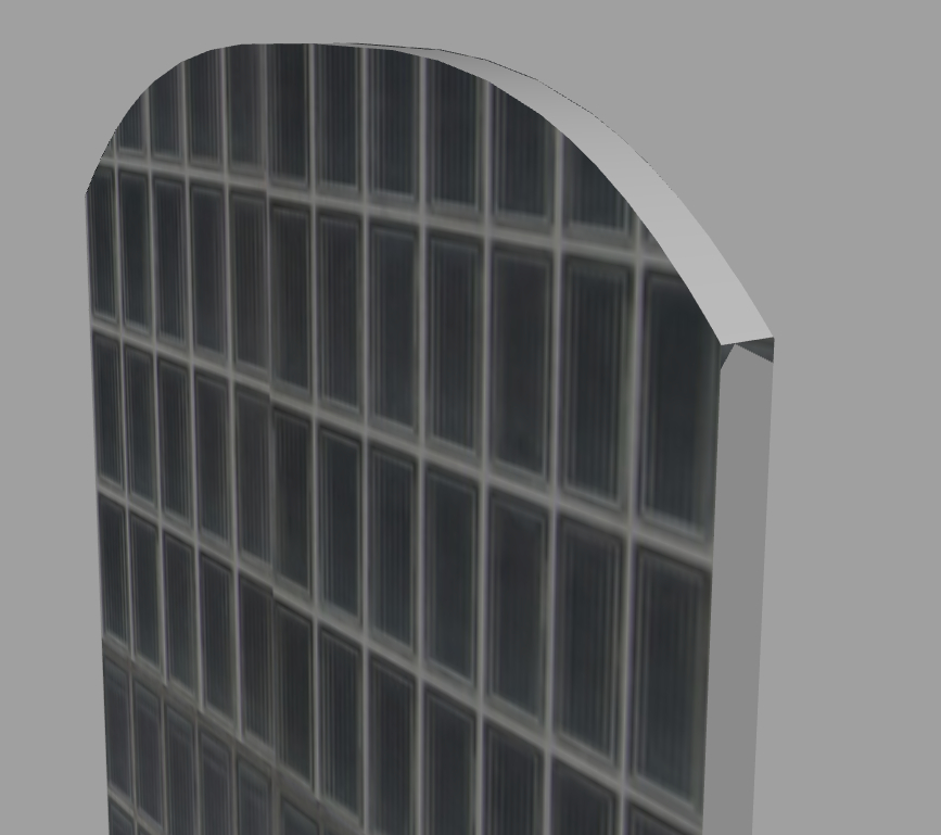

Hello Pascal,
Could you please help me? I am a beginner at Rhino and I cannot fix the problem although I applied your steps. Here is my window sample. As you can see, there are some weird areas close to the corners.
or here is the rendered mode:
And I also attached the 3dm. file.
Thank you in advance. I’ll be looking forward to hearing from you soon. :pray:t4:
Pinar Aksu
window_sample.3dm (321.7 KB)
@aksupi
Your model is more than 5476 KM away from the origin ! ? Any reason for this?
If you move the object close to the origin the artifact will disapear. Anyway the reason for the artifact is something to do with floating point precision…
I don’t understand. I didn’t do it intentionally, but I think now it is on the origin. Is it? However it still has that weird part… Do you know how can I fix it? :pensive:
window_sample2.3dm (333.9 KB)
Hello - select the object, start Move and snap to some location on the object as the From point. Then as the point to move To, type in ‘W0,0,0’ and Enter. Then Zoom Extents.
Then RefreshShade to finish.
Any luck?
Oh, thank you so much! :pray:t4: :heart: It worked perfectly.
