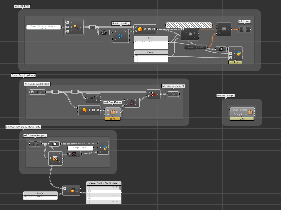

Hi all,
In 8.9 SR the Query Model Objects component is failing to correctly return User Text values unless the Model Object output is first cast to a GUID component.
Please see the attached files to reproduce the issue and a video demonstration.
(Pay attention to the “Incorrect Values From GH Doc” Panel(s)
Graph Space:
I was pulling my hair out for two days thinking I was going crazy that my “sorting values” weren’t working correctly until I finally traced back the issue haha
Almost all of our scripts rely heavily on getting real-time user text values so we will put a GUID component downstream of the Query Model Objects component for now as a temp fix.
Thanks for your help!

Okay sorry @Japhy, I dug around more and realized that in a different part of the script I had a Python component setting user text values which worked great for the updates being live in Rhino but I was not calling a refresh of the GH script, thus the Query components weren’t getting the latest values (unless a GUID component was added? which confuses me… I guess that’s because it’s then calling directly to that GUID object vs passing through a Model Object?)
I believe this was the issue why the UserText values weren’t being updated from the GH components dynamically.
Sorry for misleading you all on that, it now appears to be working just fine (the grasshopper components, not my script yet)
I wish there was a way (or perhaps there is) to refresh specific components or upstream components, I was able to refresh “downstream” logic by calling ExpireSolution(False) but unsure how to update the upstream Query Model Objects component so that the Model Objects coming out have the proper User Text values.
@AndyPayne and @kike or maybe this is a @scottd question, what method is being called within the “Synchronize” menu option of the Query Model Object component?
My question is, if I set UserText from a Python script how do I ensure that the referenced Model Objects from the Query components are always getting the latest and greatest attribute values without carpet bombing the whole script in a recompute?

This is a bit confusing in that the Rhino Objects with the python components. These components point straight at the Rhino.Object within ActiveDoc.
The test here:
Is testing the ObjectModel element within Grasshopper.
I think the best way to explain it is. The Content Cache Pull (Result) will sync all the attributes and ID from the Rhino.object and transfer that information to the Model object. But, these are not the same object. So the Python components are only updating the Rhino.Object. The ModelObjects do not change. An additional Content Cache pull would be needed to sync the model object to the Rhino.object updates.
