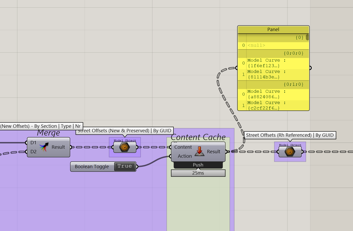

Model Object with empty Object input outputs a <Null>

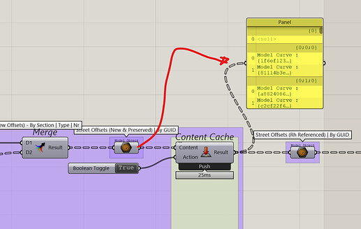

One thing that is frequently messing with my data structures is the Model Object output. Since I am only recomputing those objects that changed (offsets of curves and surfaces that I build from the offsets), I may get to situations where when I only delete an input curve for the script, the Model Object Input for new objects is empty. In that case, it outputs a <Null>, which changes the data structure later when merging the various data streams together (new objects, modified objects and objects to preserve).
So my question here is, shoudn’t the output for the Model Object be empty instead?
E: It’s not like the <Null> output contains any useful data either.
It should actually be empty, it is empty elsewhere in the file and when I place a new Model Object Component, it is also empty. Not sure how it got to this point. I have seen this happen quite a few times in the past and now on version 8 SR25 (8.25.25287.14001, 2025-10-14).

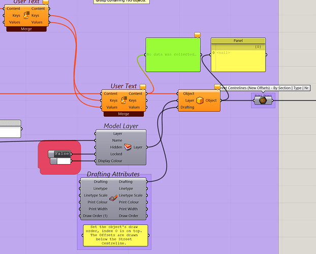

I’ve removed any non-necessary components (can’t internalise any model objects or model layers). So in certain situations there are no objects to recompute (to update) and then I have empty inputs going in like in this sample.
Null object in Model Object.gh (39.7 KB)
