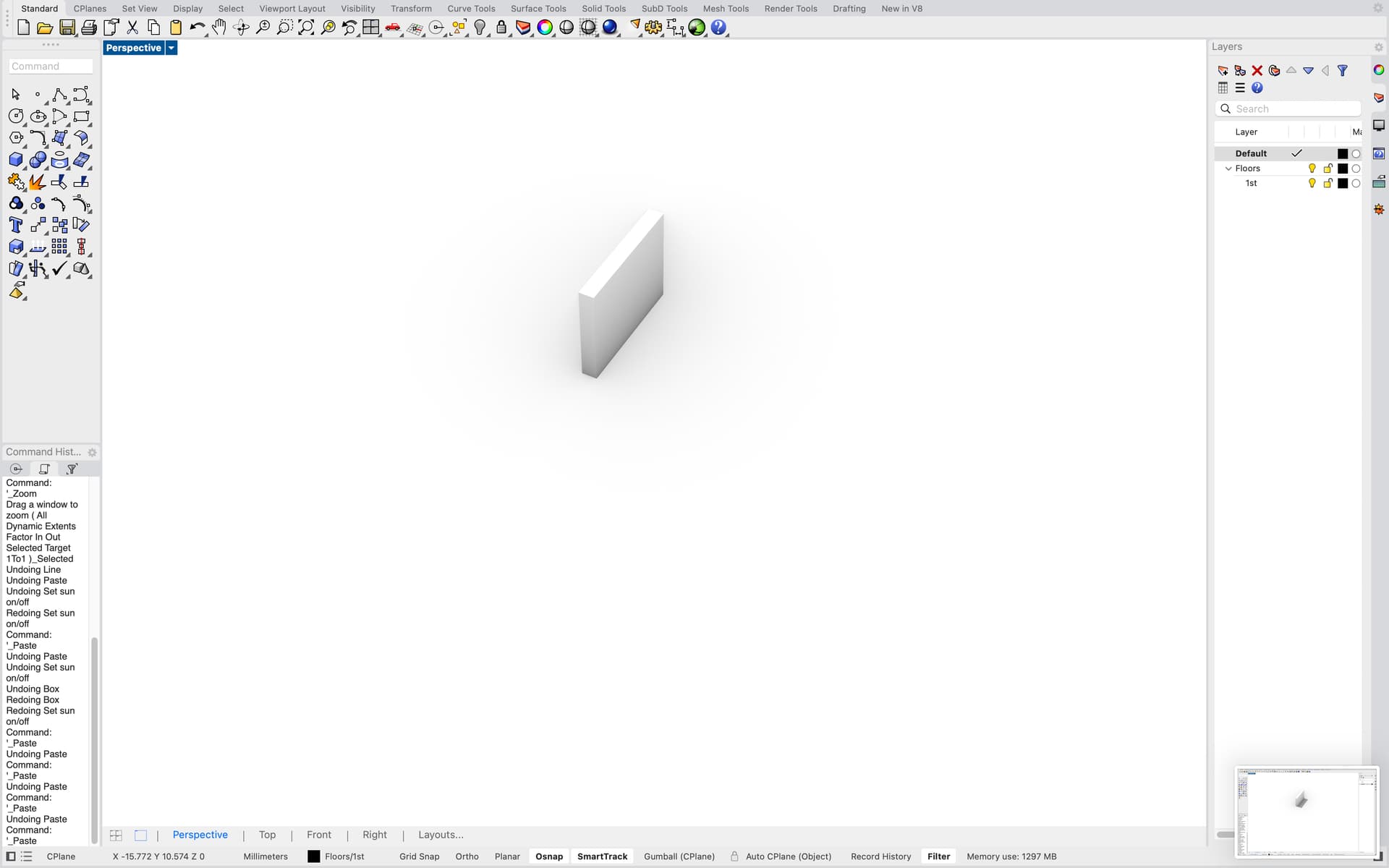

I’ve gone through everything that I found on this thread to try to fix my missing shadows in my rendered view, but still no luck. Could I get some help as to what could possibly going on? I’ve attached screenshots in case it helps.
maybe you have some objects deeper down making your ground plane not show up where you might expect it. this or you turned off your light in the general section, but since you have some shading i assume its the ground plane. try making a manual plane under your slabs.
I just double checked and there isn’t anything blocking my ground plane. I also tried creating the surface under the extrusions, but still no luck.
I’m attaching a screenshot with the lights tab showing on the left; I think this is what you are referring to, and everything seems to be turned on.

So I reset it, I created a new file, and it worked.
However, when I went to the file where I originally identified the problem, I still couldn’t get any shadows. I did a few experimentes and figured this out which is shown in the screenshots, in order:
  1. I create a box in a new file and the shadows work fine.
  2. I paste something from the original problematic file into the new file and the shadows disappear (even if I paste just a point as you can see in the pictures).
  3. I move that point closer to the object where I want the shadows, and they start working again.
Do you have an explanation for this? If I can figure out why this happens then I can fix the file with all my work on it.
