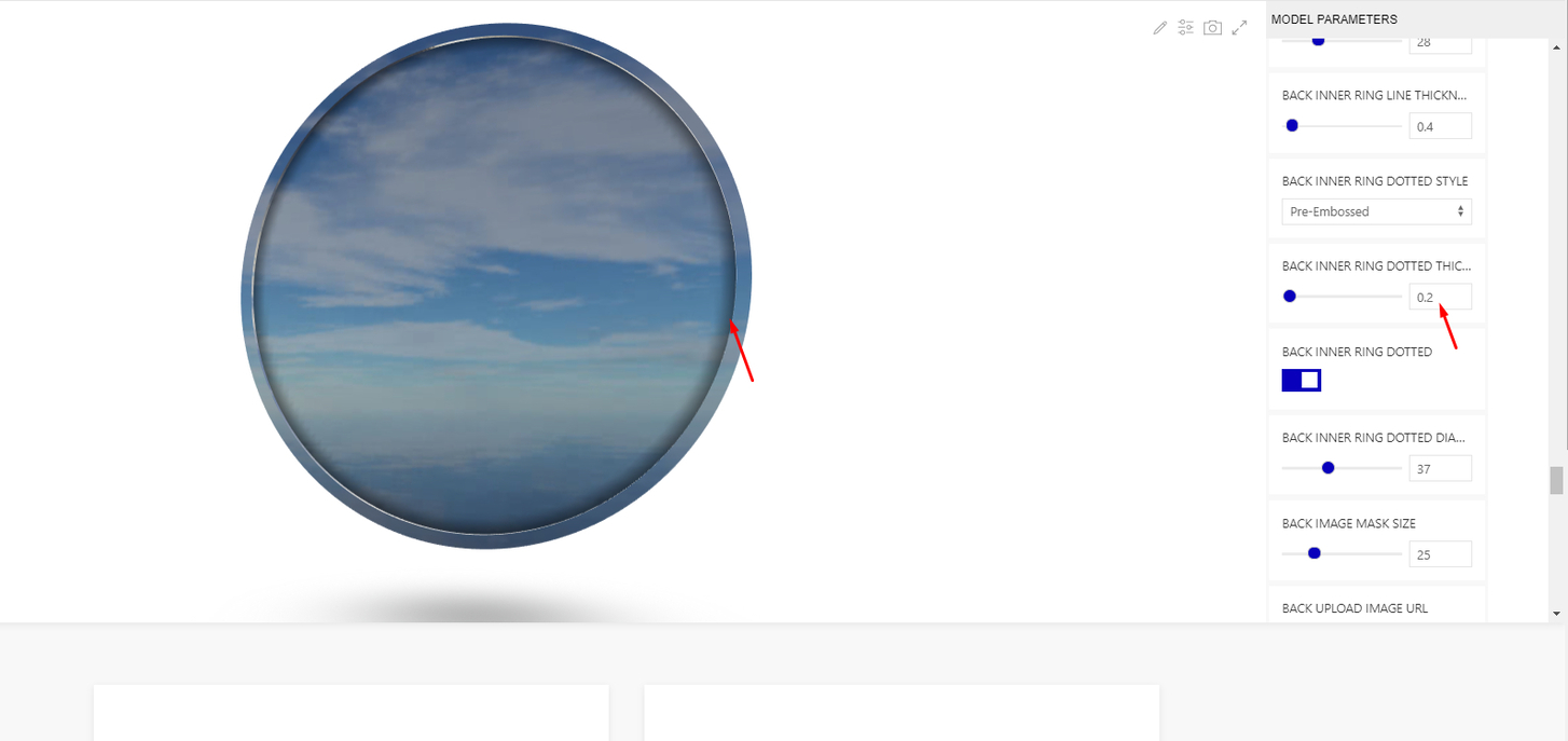

  2. Currently, I need to set the value of the dotted line below 0.4, I tried it but can not apply to the 3D model

Regarding your second point, I am able to go below 0.4. Please check this screenshot:

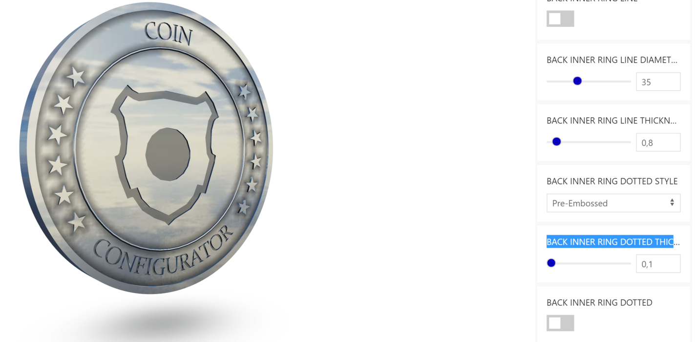

Hi Edwin, you have not activated the “back inner ring dotted” in your screenshot. when active and setting below 0,4 it does not show
Hi @hemmrich, now I get the problem. Please check this new model with the solved problem: https://app.shapediver.com/m/200703-coinconfigurator-1
Hi @edsahergom, I tried this on the new model, with the value is 0.1 it shows correctly, but the value is 0.2 to 0.3 it does not apply to the model. Please help us check it again.
Hi @thangnm, please check this model with the fix: https://app.shapediver.com/m/200706-coinconfigurator
Hi @edsahergom it’s works fine, thank you for your help
