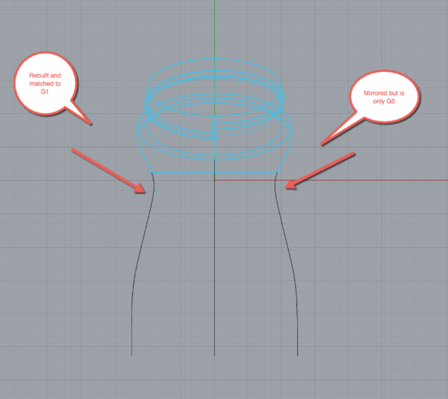

I have a curve created from two views. I rebuild it and match it for tangency to an edge of an object. The G rating is then G1. However, when I mirror that curve to the other side is only G0. If I use match curve to make this tangent (G1) as well, will that make the mirrored curve no longer match exactly?
Are you talking about the continuity between the curves and the edge of your object? Maybe it’s the object that is not symmetrical…?

If you ask GCon about the curves and the edge of the surface, not the curve that is sitting there right on the edge, then both mirrored curves are G0 by the same amount, so to speak - 3+ degrees out of tangent.
The curve in the file along the edge is not symmetrical. Grab the curve, move it up in front view vertically to see better. Then cut it in half along the Y axis in the front view, and mirror one half over the other. You will see a difference at the end.
Okay, I think what you’re referring to is the curve that was projected to the c-plane. Is there a modeling setting that would make for more precise modeling? That curve was taken from edges extracted from the central object that had been trimmed with a line on the perpendicular c-plane. Is there something I’m failing to do in the process?

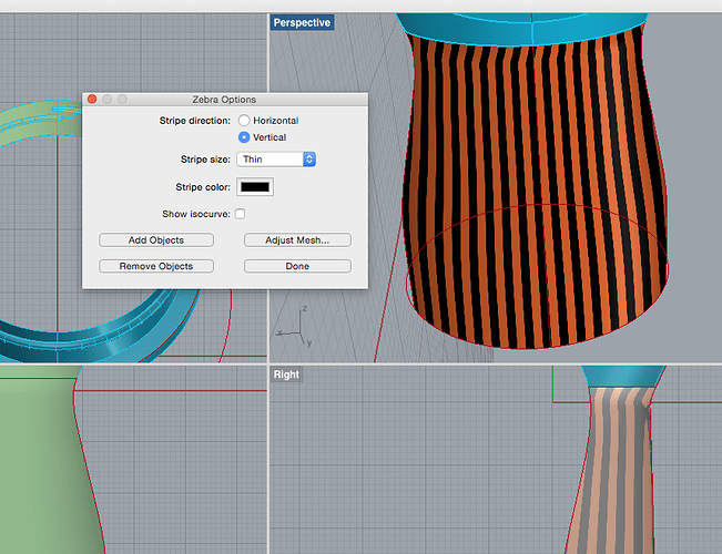

Well. that’s the rub. I can’t finish the model because I keeping hanging on this problem. I’ve rebuilt the model from the images up several times and I keep getting bad surface matches. What settings do you use pertaining to the absolute and relative measurement derees? The default is (metric) absolute tolerance.001 / relative tolerance 0.1 / angle tolerance 1.0 degrees. Is that suitable?
Is it between your blue & red Portions? If so, I will try to build it tomorrow morning from your curves. I have your screen shots to go by, then I can probably give you a better workflow on how to make an odd shaped bottle / container. Off for the night!
Not getting into tolerance settings, I just leave mine at default. I took your existing curves and rebuilt one to make it target to existing edge. Your curves are no good here. Check layers.
Mirrored it and split front curve at blue object edge. Circle 3 points at bottom, split at side curves and duplicated the blue object front edges & joined. Surface from network curves, choosing top nd bottom curves then 3 vertical curves.
curves to blue surface edge are both G1.
