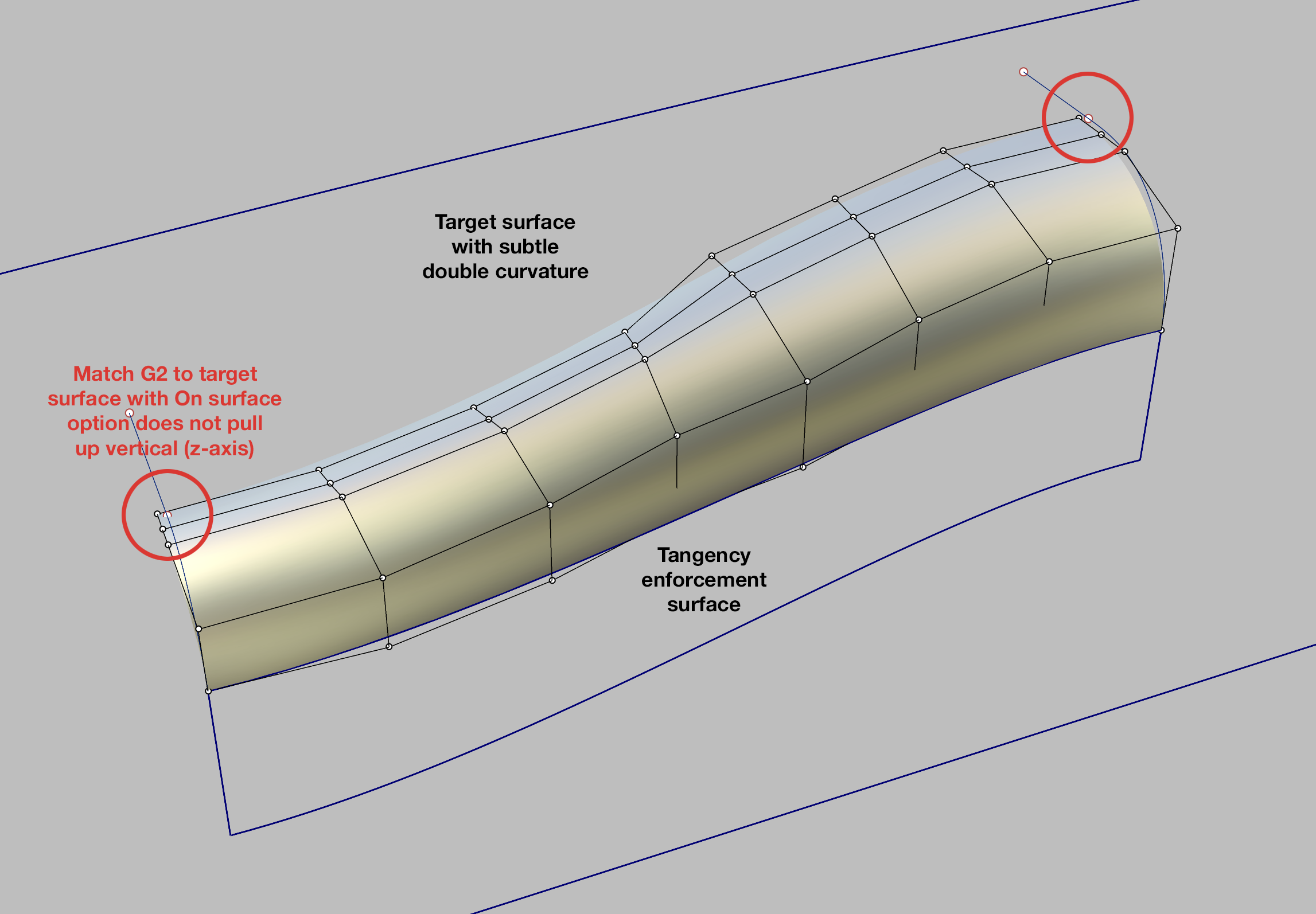

Match surface G2 with On surface option
When matching a surface G2 with the On surface option, the edge of the surface is not projected onto the target surface in the z-axis direction (maybe normal?). There is no x, y, z, normal selector like in other software, when using the On surface option. What would be the “Rhino way” if I want to use the z-axis here?

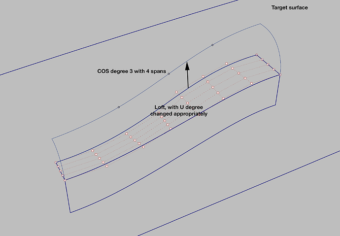

  • Loft between the degree 1/7 tangency enforcement strip to the degree 7 curve to be projected, which results in a flat single span degree 3/7 surface
  • ChangeDegree of that surface, changing its U degree from 3 to 4 to obtain two free CV rows for G2 alignment, 1 free CV row for G1 alignment
  • Project Direction C Plane Z the degree 7 curve onto the target surface, which creates a COS (curve-on-surface) of degree 3 with 4 spans
  • Match the surface G2 with the On surface option, selecting the COS and then the target surface

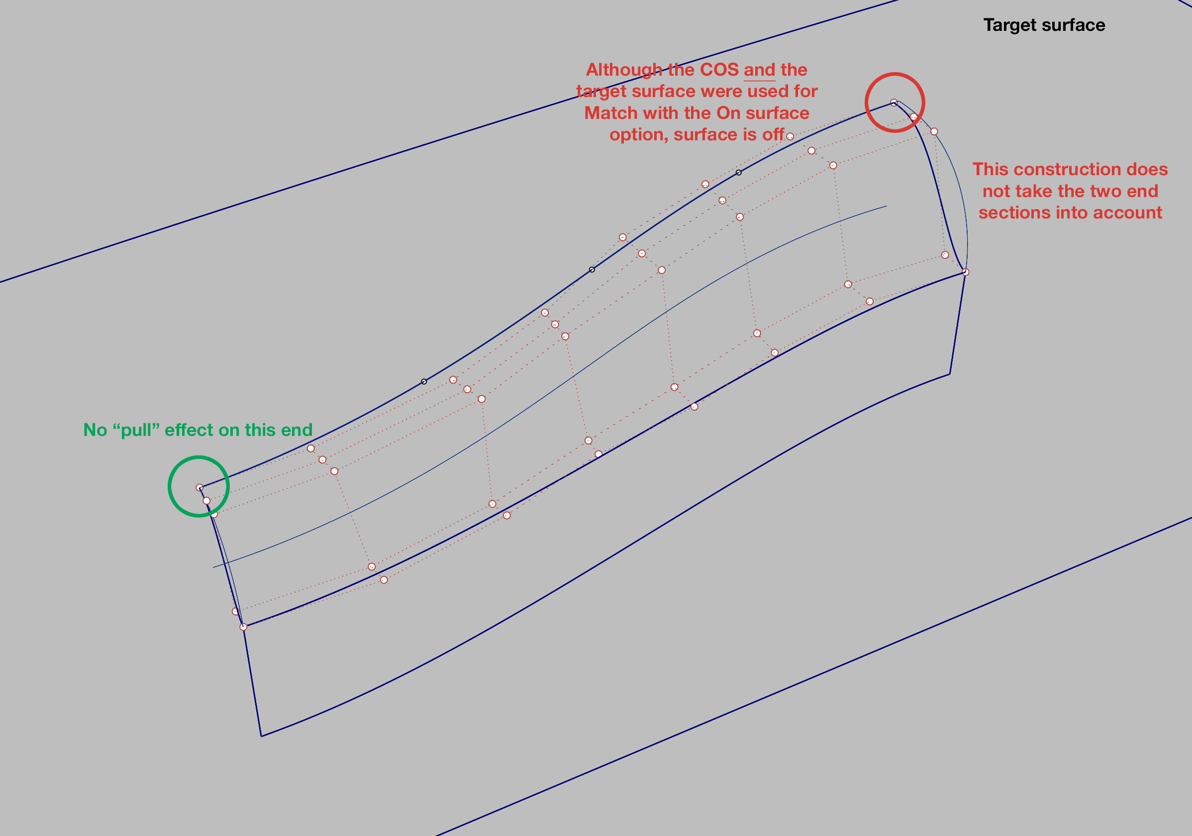

Unfortunately, it’s not working as expected (apart from the secondary problem that the two end sections are taken into account).

Turn off “Match edges by closest points” and the match will be to the entire curve.

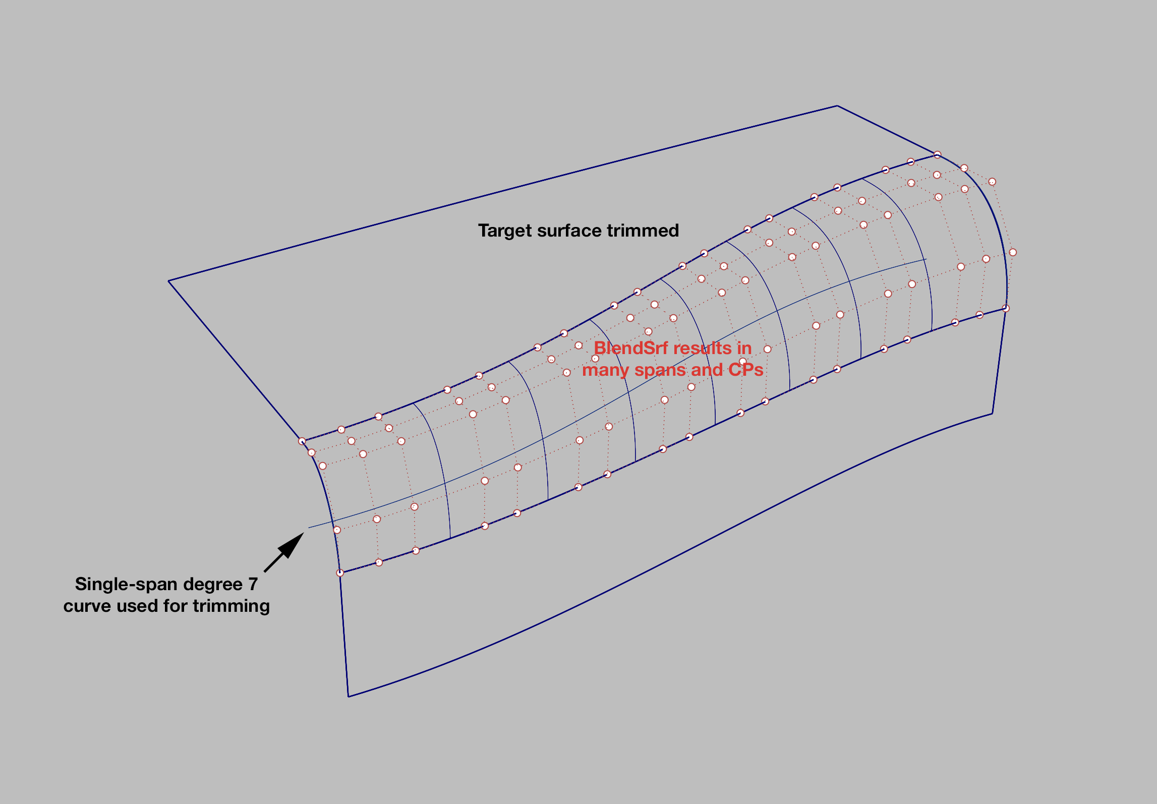

Interestingly, instead of matching with the On surface option, trimming and using that trimmed edge delivers a nearly identical result.

Well it should do that. Although McNeel rarely reveals what these sort of functions are actually supposed to be doing, I believe the idea behind the OnSurface=On option is so that the user does not have to trim the surface then match and then untrim. This option can be useful if done in conjunction with History where the inputs can be modified with history.
Here is what I got. Match On surfacex.3dm (83.7 KB)
I used Sweep1 to get a two span surface that matched the lower rail. If your two rail curves had the same knot parameters you could use sweep2 or edgesrf to make a simple surface. Because the knot spacing doesn’t match is why edgesrf makes a more complex surface.
One thing that I have observed about match surface is that it matches to the underlying surface and not the curve. What I mean by that is that most often when you match to an edge or a curve OnSurface you will get a more accurate result if you trim the surface with the edge that was just modified by matchsrf. That means untrimming and then retrimming if the match was to an edge.
For example, in the file posted above if I trim the large surface with the green curve (either before or after using MatchSrf) I get two surface that are about .008 apart (the edges are out-of-tolerance). OTOH, if I trim the large surface with the modified edge after matching, the two surfaces end up well within tolerance.
In other words, if you use OnSurface and match to the green curve and trim with the green curve you get out-of-tolerance edges, but if you trim with the newly created edge (on the pink surface) you get edges within tolerance.
The same thing if you first trim with the green curve then match to that trimmed edge. You will get out-of-tolerance edges (unless you use McNeel’s refine option and make the surface more complex). But if you don’t use refine and you untrim the large surface after matching and retrim with the modified edge on the pink surface the edges will be within tolerance.

FWIW, in Rhino 9, you will be able to Rebuild the target curve to single span degree 7 with very little deviation (Maximum deviation = 0.00116161), then sweep 2 and match. End result will be similar to what Jim has posted, but maybe a little easier to digest.
Attached is the result before matching
Elmo-rebuild-Sweep2.3dm (100.6 KB)
