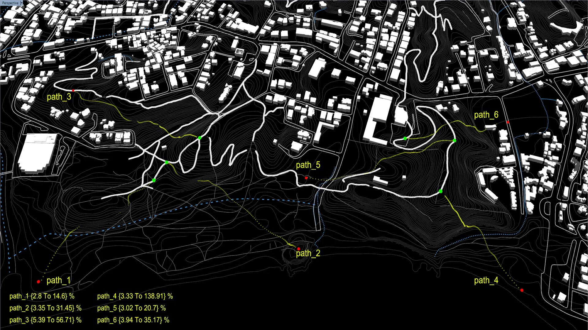

It is so cool it even works with multiple curves. The wee problem I have are small intersections…
But it is where drag component would help I supposed. Collide doesn’t seem to do anything:)
Will do another test on a real mountain. And will try to solve junction :thinking:
PathFinnding_Kangaroo_Routes_01.gh (197.2 KB)

Very nice @ng5_Alex. On a first sight looks very similar to Daniel approach, the only thing he advised to add Z anchored as well so the slope tries to be the same on all segments of the curve.
Have you tried making an intersections? For example two roads are crossing each other ?
the version i shared anchors z through curve pull, not aiming after segment slope equality, but as an alternative to pull to surface goal. i also found useful to associate the path resolution, as in polyline segment parts, with the contours of the terrain itself.
the definition comes back from 2014-15, where kangaroo wasn’t the beast kangaroo2 is, though K1 was/is more than awesome at the time. Intersections between two paths can happen, but if you are targeting to happen, i can see goals of kangaroo2, like transform and magnet snap towards this direction.
btw is this for a student or pro project?
Neither student nor pro. Working on my own research. I work for a practice where predominantly everyone uses SketchUp/Archicad, this manual modelling atmosphere gives a lot of ideas regarding workflow optimisation.
But I do design and urban planning in hilly areas where Kangaroo might help. not sure if it is going to be used professionally unfortunately.
