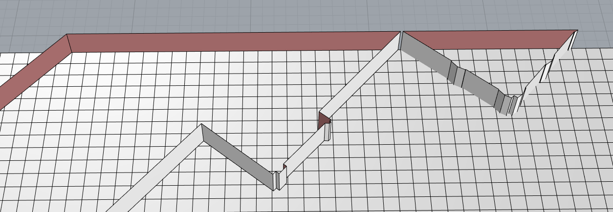

Your example shows some problems already with the cutter meshes having self intersections. As long as you have cases like this, Mesh.Split will likely fail to split the mesh plane.

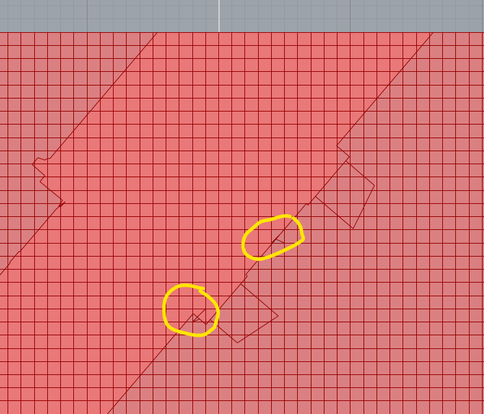

Having coincident mesh edges in the split operation as shown below is not recommended:
Better would be to try to extend the splitter mesh away from the mesh plane so it is a clear intersection. If you’re unsure if the operation will succeed, just intersect the meshes and analyze the resulting polylines. If they overlap, it is likely that the split will fail.

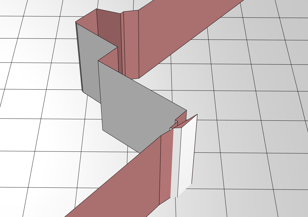

Having coincident faces in your cutter meshes as shown below will likely prevent that the split operation will find the expected result. Remember, you’re passing all these cutters to a single Mesh.Split operation:
CuttersOverlap
