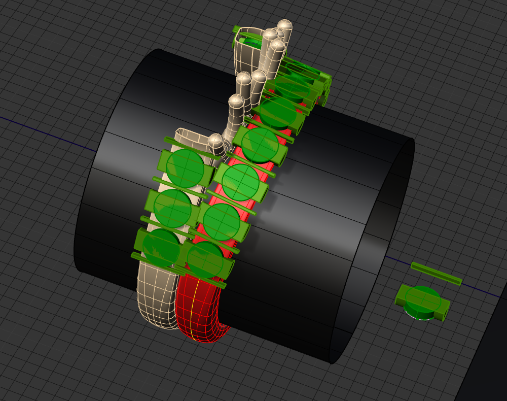

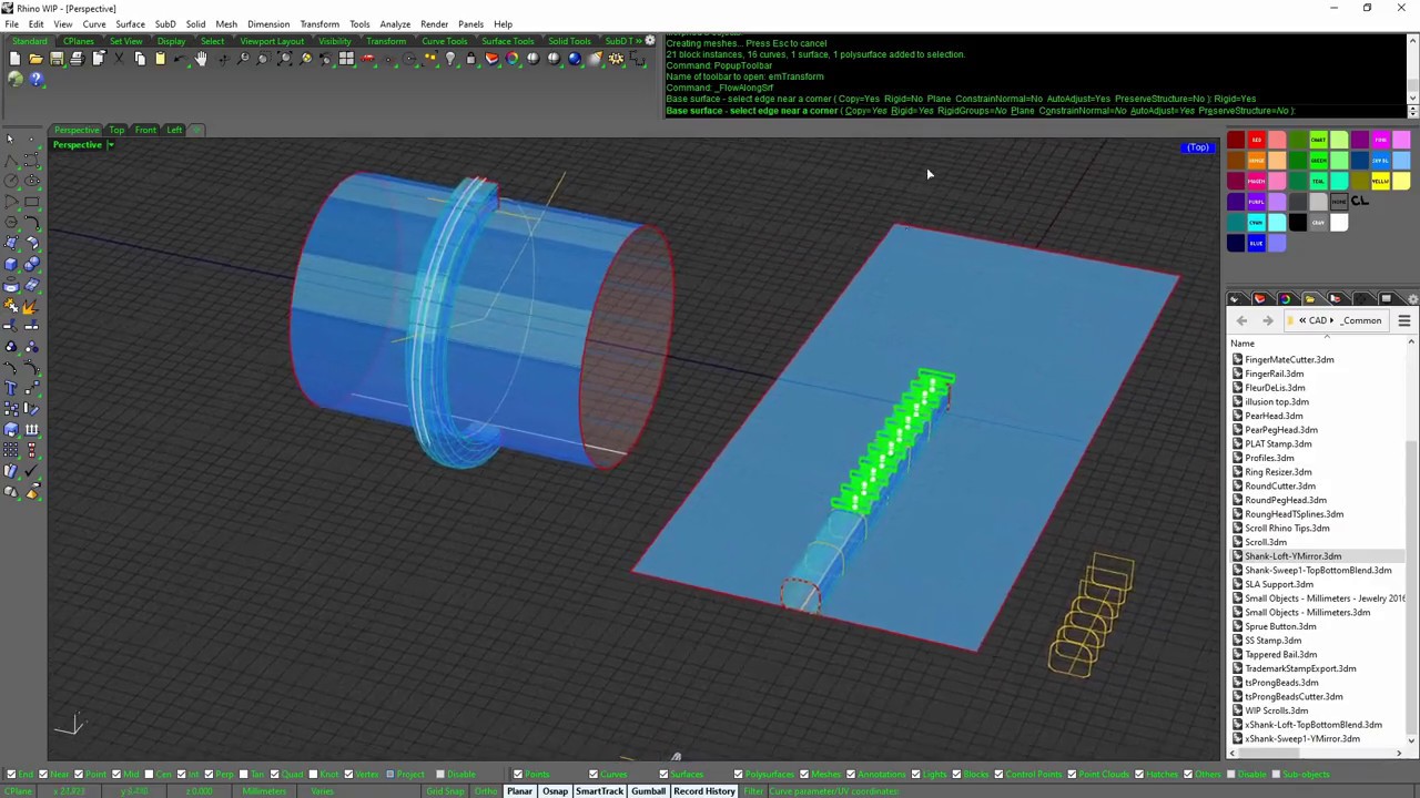

This is part one showing how powerful history can be with MergeCrv and CurveThroughPolyline. I plan on recording more demos as I can.
Shank Template Files Using MergeCrv and CurveThroughPolyline:

@pascal, all the comments from the other forums and YT mention better tools for stone layouts. The major issue revolves around controlling the reference frame for space morphs.

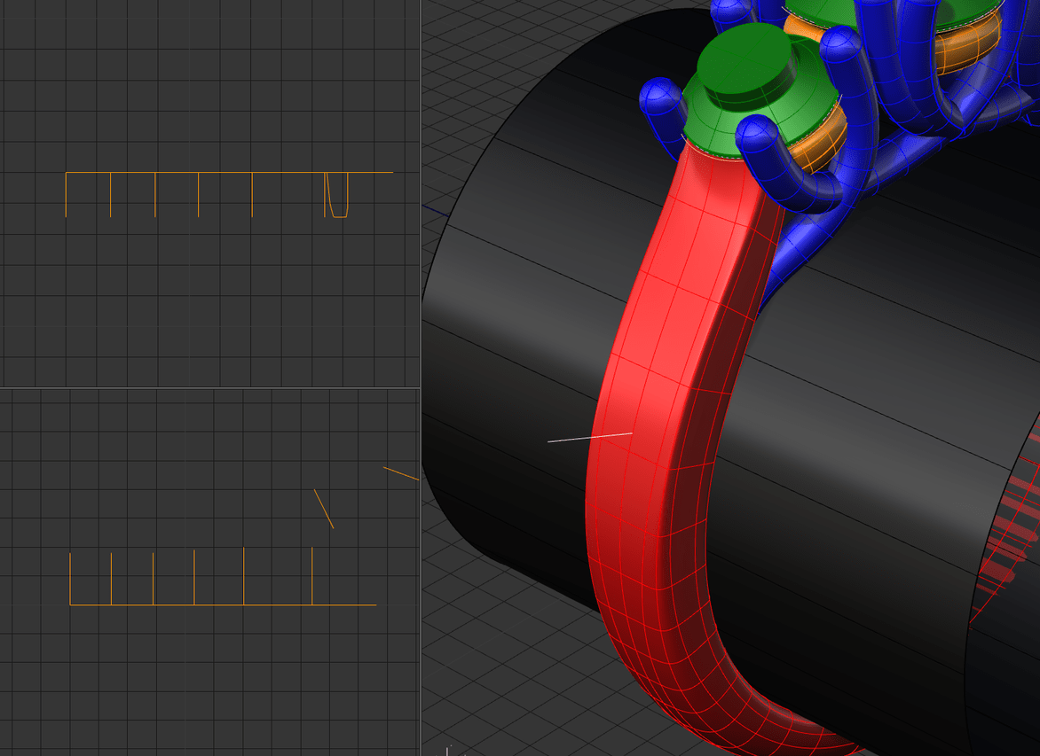

I talked to @dale a good bit last year trying to figure out how to control the surface parameterization for FlowAlongSrf. That would be optimal, but it’s extremely difficult.
I have a new plan I will detail soon, but it feeds a surface normal into _Flow. That’s what @Jarek is doing with Armadillo.
Rhino FlowAlongSrf mapping base UVN to target UVN:
Armadillo creating a target plane using point on curve + nearest surface normal, then orienting plane to curve normal:

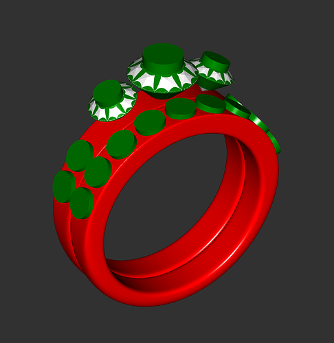

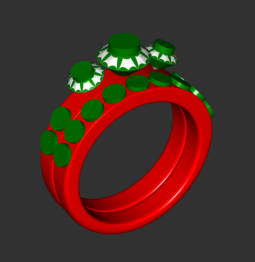

I went ahead and wrote it up.

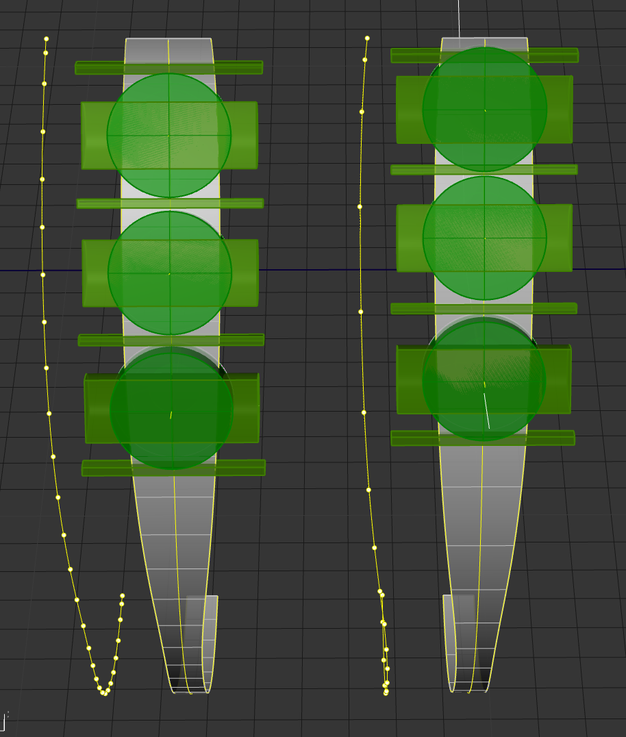

Christmas miracle for a Christmas delivery. I saved at least an hour on a last-minute request to change a flat band into a cathedral shank with trellis head.
Took less than 60 seconds to update the universal shank, but now the shank has really inconsistent parameterization and is a terrible FlowAlongSrf target…
…but the new history enabled rebuild ( RH-56271) fixed that issue in another 60 and gives me all the history I need to make further tweaks.
ExtractIsoCurve
Rebuild DeleteInput=No
Mirror
Loft

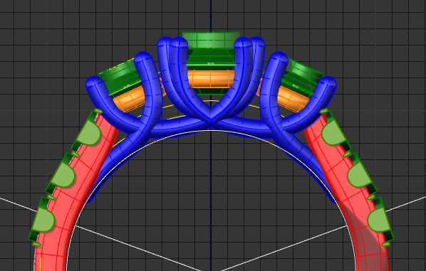

FlowAlongSrf
And there’s even some MergeCrv (RH-45817) goodness hidden in the trellis head.
On top of being incredibly grateful, I’m also incredibly optimistic. As soon as we get RH-56171 we will be able to use this workflow again in the same file for the matching band. And RH-56357 will give the same full history tree for easy modifications.
