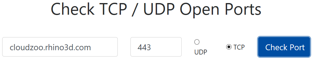

Hi Charlie - you could try disabling the firewall to see if that changes anything.
Alternatively, a tool like https://www.testports.com/ should be able to test the connection for you. Remove the https://
parts of the urls that John posted above:
Should give you: \color{green}Port: \color{green}443 \color{green}on \color{green}host \color{green}cloudzoo.rhino3d.com \color{green}is \color{green}Open
Wim, thank you. I have tried disabling the firewall and connecting with no success. I tested both URL and ports and they are both open. Thanks for the suggestions.

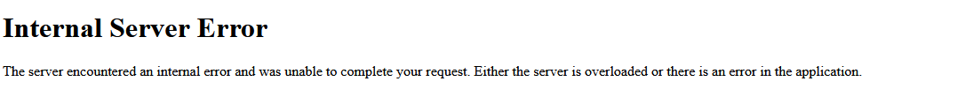

- Cannot access api.mcneel.com via browser
- accounts.rhino3d.com and cloudzoo.rhino3d.com are accessible via browser
- In the Rhino3D app, one of the prompts read ‘accounts.rhino3d.com’ and ‘api.mcneel.com’ are not accessible.

I am still unable to connect to my license. I have tried to validate my license manually but I get this error.
I’ve also tried removing my offline license and adding it to the cloud zoo. I get this prompt:
Hi -
I’m afraid that means that something is preventing you from getting out in the world and this is not something that we can fix for you.
