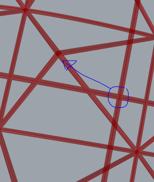

I created two surfaces from a single line (so if you need to define the curve at the beginning of the code, its a line with a length of 9200cm)
anyway, im trying to create some trusses between the final 2 surfaces… but my list dont seem to match one another… ive tried everything i know, reverse lists, flipping stuff, whatever… couldnt put my finger on it.
can you guys and gals try to help?

Have a look at the attachment.
מסבכים_re.gh (17.1 KB)

ok so this is an excellent solution, except:
this will be actually built. and as a truss, this cant work since the weight distribution is non existing…
the top chord have to be supported by the diagonal members… as seen in the pic.
I don’t think the truss structure works that way.
And there are so many truss tutorials, so please search …
Or, if you use this code well, you can make what you want.
