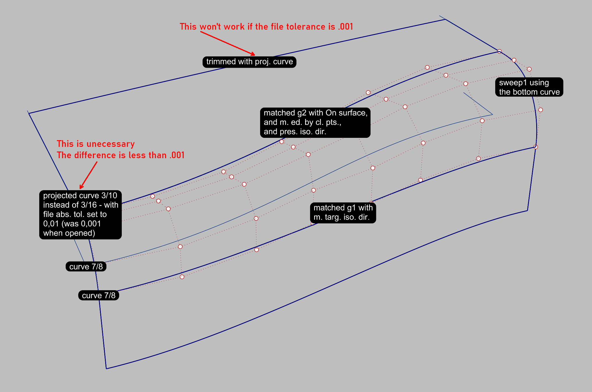

I rebuilt the curve on surface to a single span degree 7, with the deviation posted
Ah, got it. Odd though that Jim’s projected curve is degree 3 with 7 points, whereas mine is degree 3 with 16 points, and even odder why Sweep1 only allows selection of one sweep shape. Something dodgy with my V8 version or macOS, or both, I guess.

Tried that also, deviation here is even less. Still, once matching G2 with On surface, and using that rebuilt curve, the CVs in the middle are pinched, like before (I worry about the Sweep1 issue later), whereas on Jim’s model, they are rather evenly spaced.

I must of somehow changed that curve, but that really doesn’t make any significant difference. Here is what I get using your original curve
Match On surfacex2.3dm (86.0 KB)
Rebuilding the curve doesn’t really make any difference because as I said matchsrf is paying more attention to the surface than the curve.
You’ll get just as good result if you use the curve you projected to the large surface. That curve would be degree3 ugly curve but that is not what matchsrf is really matching. Matchsrf is matching to the best fit of the edge curve of the surface being matched to the other surface. That usually is much closer to the other surface than the curve or edge on the other surface and that is why you have to trim the other surface using the matched edge after matching.

So, updating Rhino V8 to a later release helped, and a single-span surface with good CV structure is achievable, and very close to the Alias, ICEM, etc. equivalent.

With the method you used it won’t work with a file tolerance of .001.
It makes no significant difference to the outcome if your file tolerance is set to .01 for projecting the curve and making the sweep1 and matching the surface.
The only place file tolerance matters in this process is the trimming and joining part. Your method won’t work with a file tolerance of .001
Now that Sweep1 works, and how to use the On surface option is clear (general observation - in Rhino’s matching, it matters where one clicks, otherwise surfaces flip, etc.), I replicated this at a file tolerance of 0,001/0,1 (the projected curve is now 3/16 instead of 3/10) and the result is good.
I replicated all with 0,001 file tolerance, and it worked well. Could you explain why you thought it should not have worked?
I thought it would not work because I tried it. It appears you also tried and it did not work.
That .005 is bigger than .001 tolerance
If you trim with the surface edge instead of the curve you matched to, you will get a number smaller than the .001 tolerance. If the tolerance is .01 it won’t matter because .005 is less than .01

I get .0005 for edge continuity (postional) when trimming with the surface edge in Rhino9 (WIP). I just tried in Rhino8 and Rhino7 and got the same result.
It only takes about 10 seconds. Run Sweep1, then MatchSrf, then Trim By Edge (the macro I posted above).

The surface won’t join in Rhino without overriding .001 tolerance in some way. Did you export as STEP or IGES as loose surfaces and Creo joined them?
Trimming with the surface will always fail for two reasons. First the surface doesn’t go all the way across the surface you want to trim (or split). Second in order to trim with a surface Rhino has to calculate an intersection curve. In this example Rhino can’t calculate the curve even though the edge is within tolerance.
The only type of tangent surface where trimming with the surface works reliably is when the surface is an arc based surface made by FilletSrf. That has worked since Rhino1
This is where the macro , I posted above, comes in handy. Run it and it will only accept the surface edge as input (so no bother with selection menu or accidentally picking the wrong curve). After the macro extends the edge, the trimming works and it automatically deletes the extended curve.
