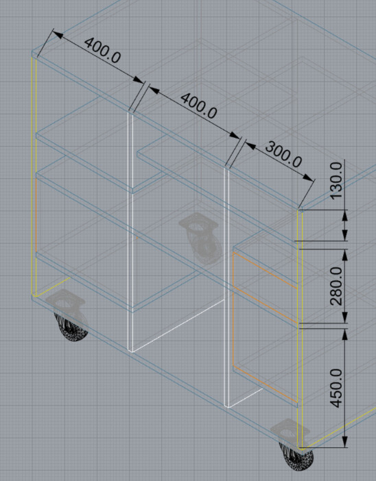

Hi Wim, is it possible to keep the dimensions in the angle of the isometric view, as in the perspective viewport?
I add the images:
01 thats how i want it to look like
02 thats what i get
Hi Johanna -
You’ll need to explode (a copy of) the dimensions and text to keep the angle.
