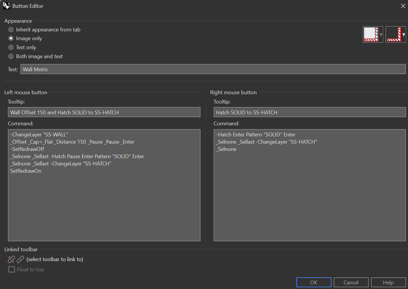

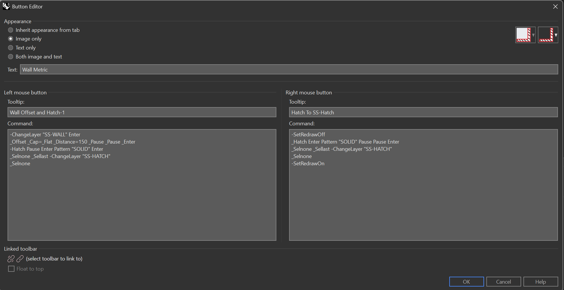

I have a button with macros that have been working fine for years, and suddenly are broken. Pretty basic 2D stuff.
Anybody have thoughts?
Thx
-Alan
Are you getting any errors? What is in the Command Prompt Output? Do you have an example file?
Hmph, I think it had something to do with the way each file is set up (I bounce back and forth inches and mm) but not sure. Working now after playing around with the Macros. Here’s what I’m using now if anyone is interested. This is for mm, and will only work if you have the nec layers already available. (It’s not a script where it will make them for you, though that would be pretty easy to set up.)
