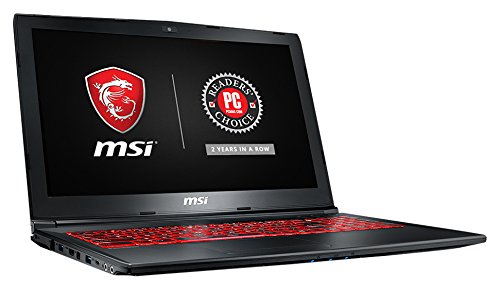

On the cheaper side of things, I’m also looking at the MSI GL62M 7-REX
I have a MSI GS60 and won’t be getting another MSI, just ordered a thinkpad P52s. The MSI is has very noisy fans, gets super hot and the battery lasts for about 15 mins.
Just my 2cents
